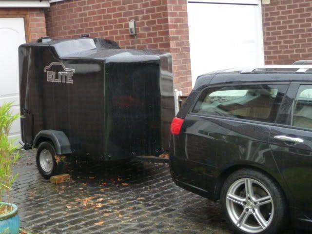

I've got this for sale. Will take 350 as a bit o work is needed on the tailgate gas struts.

Now that is a smart ickle trailer...buy it! Much better than an old heap with a tarpaulin bungy'd over it.
Posted : 02/06/2011 11:45 am
four bikes go in nicely with the front wheels off + SHED load of kit.
Posted : 02/06/2011 11:56 am

If I'd have seen that a couple of months ago I'd have been very interested.
