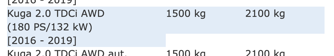

My wife tows her horse very well with this - so you are looking at those sorts of figures...
...two small ponies or one horse - for two 16.2hh horses you'd need 3.5t towing capacity.

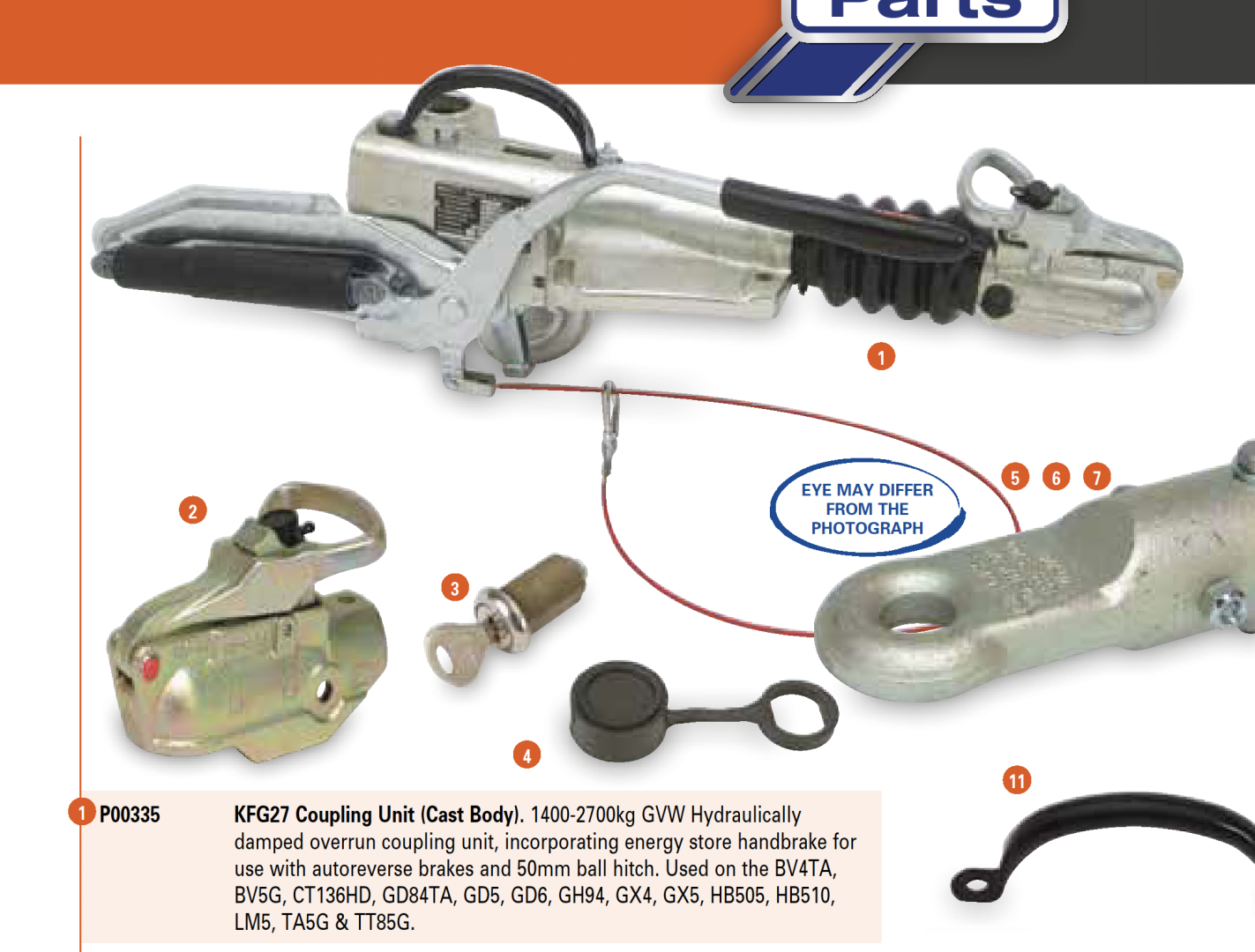

Something like a new Hyundai SantaFe (in my eyes a big truck) can only tow about 750kg from memory!
That would be the limit for an unbraked trailer surely? Horse trailers are all braked.

Posts: 13849
@johndoh
That could be the max loads for the towing hitch not the trailer. Many get replaced over the years as they fail (my wife's has), so it may not be original.
Knott seem to be a maker of those!...
https://www.knott-trailer.co.uk/auflaufeinrichtung.html
Posted : 14/02/2025 1:37 pm
Posts: 13849
Just looked on Ifor Williams parts list too and this the the coupling unit they use - rated from 1400kg to 2700kg. So that's it's operating range not the unladen weight of the trailer...
...but as above, our Kuga is great - 4WD, 180bhp - no trouble at all with one horse and that Ifor Williams trailer.

The photo is the hitch plate. There should be another one with maximum weight and axle weights. Ifor Williams normally put it on the draw bar
I had three different stamps on my caravan, the one for the hitch (similar to the one shown up there, i think the weight range is what the brake circuit is suitable for, but might be wrong!), the one for the axle/base/chassis (heaviest assembly the chassis is rated for) and the "plated weight", which is (by far) the lowest at 1140 kg. Think my trailer has two, chassis and plated.
The only legal ones are the plated weight.
Posted : 17/02/2025 10:30 am
Posts: 5751
Regarding the Knott trailer plate up there. The 1400 & 2700 kg fields most likely denote maximum tow weights on that particular hitch if fitted to a single or a dual axle trailer. My 2 pence worth (as someone who spends half his life towing), if it is hilly, muddy, or heavy (1.5 tonnes or more), then you really need a proper 4x4 with a low ratio transfer box. If not so hilly then look for a good heavy AWD vehicle with a slush box, something along lines of a Volvo/BMW estate. If you live somewhere flat and won't ever tow more that 1.5 tonne then your options are much more open.
FWIW I have a 1983 Landrover 110 plated to tow 4 tonnes (tax exempt), but cannot use that for business towing unless I tax it again. I would also need to refit the vacuum brake assist system to tow more than 3.5 tonnes anyway! But my day to day tow vehicle is a 2010 VW T5 with 4motion AWD. Has a rated towing limit of 2.5 tonnes and tows easily as well as the Landrover (with more power and the same weight). However, it easily reaches its limit when needing to do a hill start with a trailer full of lambs. Plenty of grip, but the clutch just won't take it for long!
