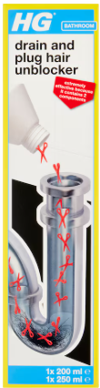

Posts: 14667
I use the drain snake thing and it either brings up nothing, or you pull out a wigs worth of hair (need pliers to pull it out), it's kinda terrifying...
I've also used Mr. Muscle & caustic soda (separately), though am paranoid about the last, as your supposedly not to use it with PVC pipes.
Should have know HG would have a product.. I'll be looking out for some
Posted : 17/06/2025 3:06 pm
