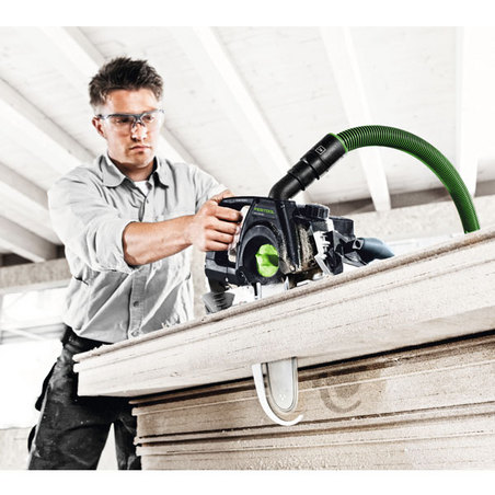

If you're not short of height, why bother putting insulation between those joists, just put all the thickness you were planning to use below them. Much less cutting, jamming in, filling gaps with expanding foam, taping with foil tape, sweeping up foam bead debris from cuts. Also much fewer joined edges, so you have a lot less chance of messing it up and leaving gaps and cold spots. Job will be done in half the time too.
Posted : 14/12/2016 4:14 pm
you just need the right tools 🙂
