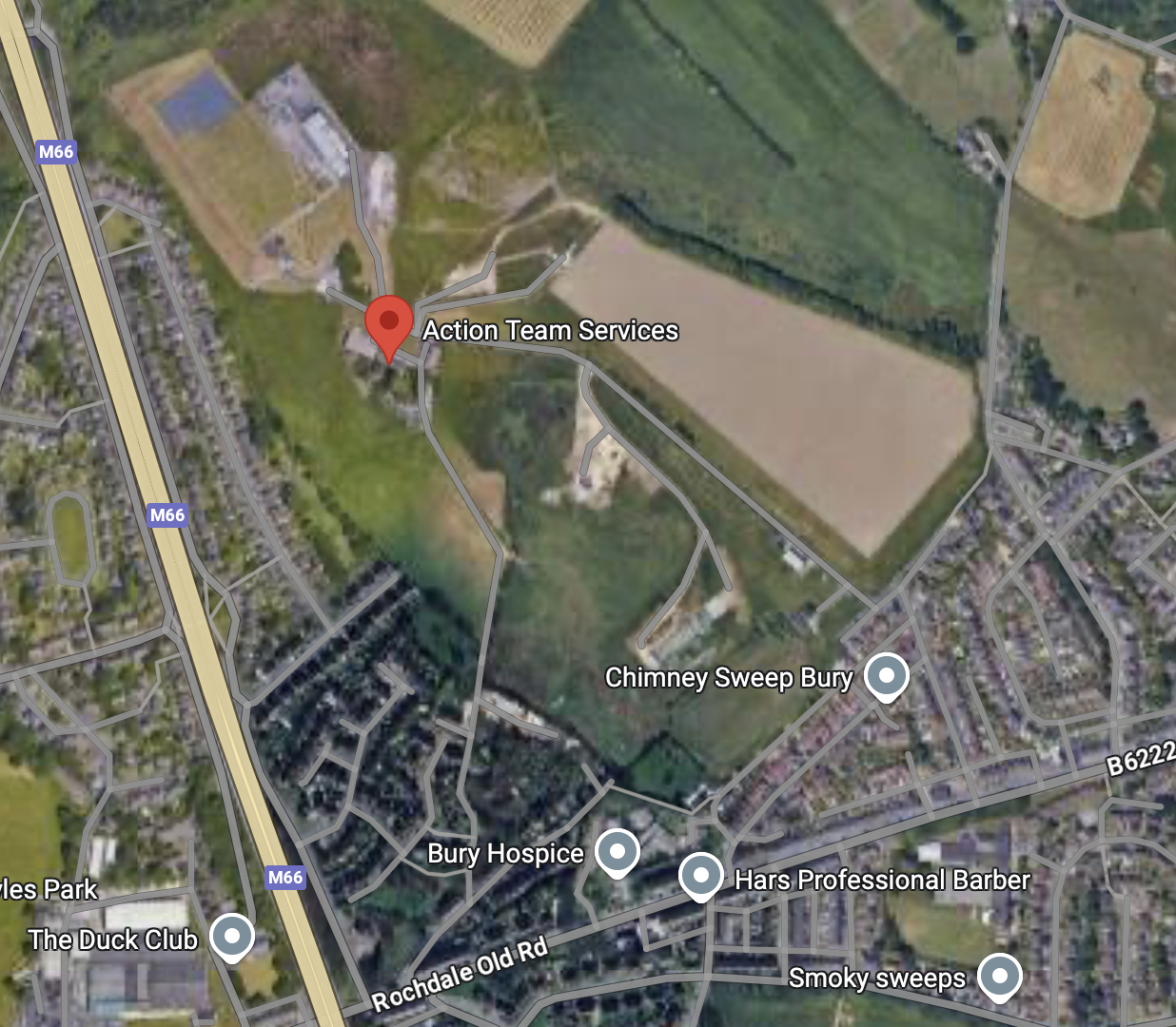

OK I've done my "due diligence" now. As you said, there is a major project to restore large sections of Haweswater Aqueduct, The Haweswater Aqueduct Resilience Programme
If you take a look at that and the interactive map you will see that the restoration works end near Bury. To the east of the M66 and north of Rochdale Old Road is a large service reservoir and water treatment works (Woodgate Hill).
My bet is that's where the aqueduct ends now.
Posted : 17/03/2025 8:16 pm
