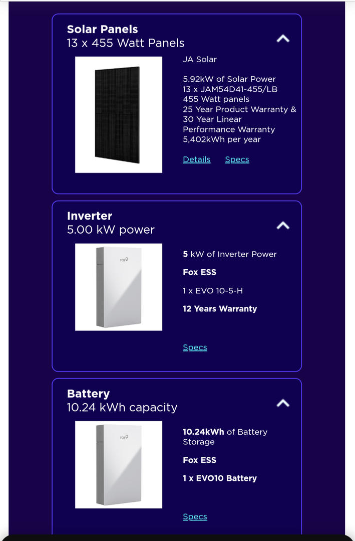

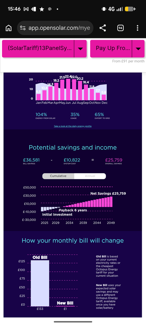

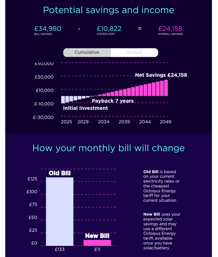

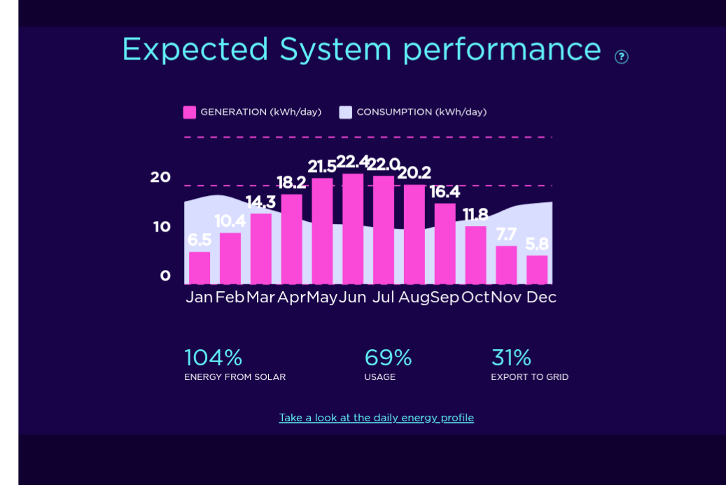

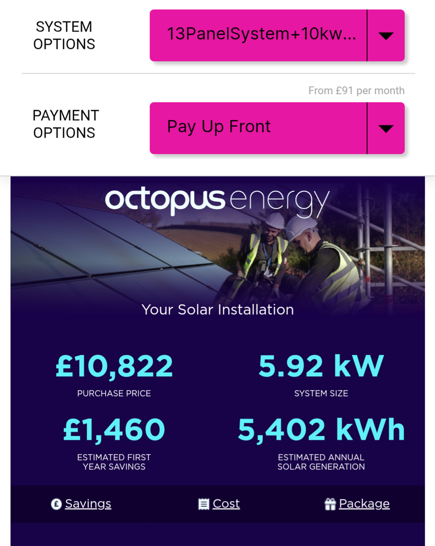

So just got a quote from Octopus
Any thoughts welcome, I know very little!
This is price with install for 13 panels amd 10kw battery
So facing roof and 6 of us we are quite big users, no EV (yet, considering a small runabout)
Do these payback numbers stack up?
Cheers stw solar follective!!
We are  mortgaging with Nationwide and they offer an interest free loan of up to 20k for green home improvements so this is what ewe are considering
Was tipped off to it here...
https://bsky.app/profile/josiahmortimer.bsky.social/post/3miixe6ures2f
Posted : 04/04/2026 1:48 pm

Always worth getting other quotes for comparison. IMO the first thing is to make sure you're maximising the roof area and sticking up as many panels as you can while the scaffold is up. Then you want to make sure the battery will see you through a dull winters day without paying higher import rates so make sure it's appropriately sized. Also if you're getting a 5kw inverter make sure they are handling the DNO application to enable you to export above the standard 3.68kw limit.
Where are you? Someone can probably recommend an installer in your area for a second quote.
Edit - re the EV. Yes you could use excess solar to charge it in the summer but it's not always straightforward. Alternatively Octopus are currently charging sub 6p for overnight charging vs paying 12p for export so financially it's better to charge the car overnight and be paid for the solar export rather than sticking it in the car. Other tariffs will come and go during your payback period so that maths will undoubtedly shift.
Posted : 04/04/2026 1:58 pm

Just checked and using the octopus feed in tariff it reckons payback in 6  years

@kimbers. We have same size array and 8.7kW battery and 5kW inverter and I think we paid around £1k more than that around 3 years ago and I had quotes from 5 companies so happy with what we paid. Looks a good quote to me. If you go for other quotes I would say compare like with like. Octopus are a large company and have a good reputation, I wouldn't compare with a local one man band etc.

octopus just subcontract so i wouldn't compare them to anyone as like a box of chocolates you never know what your going to get.
