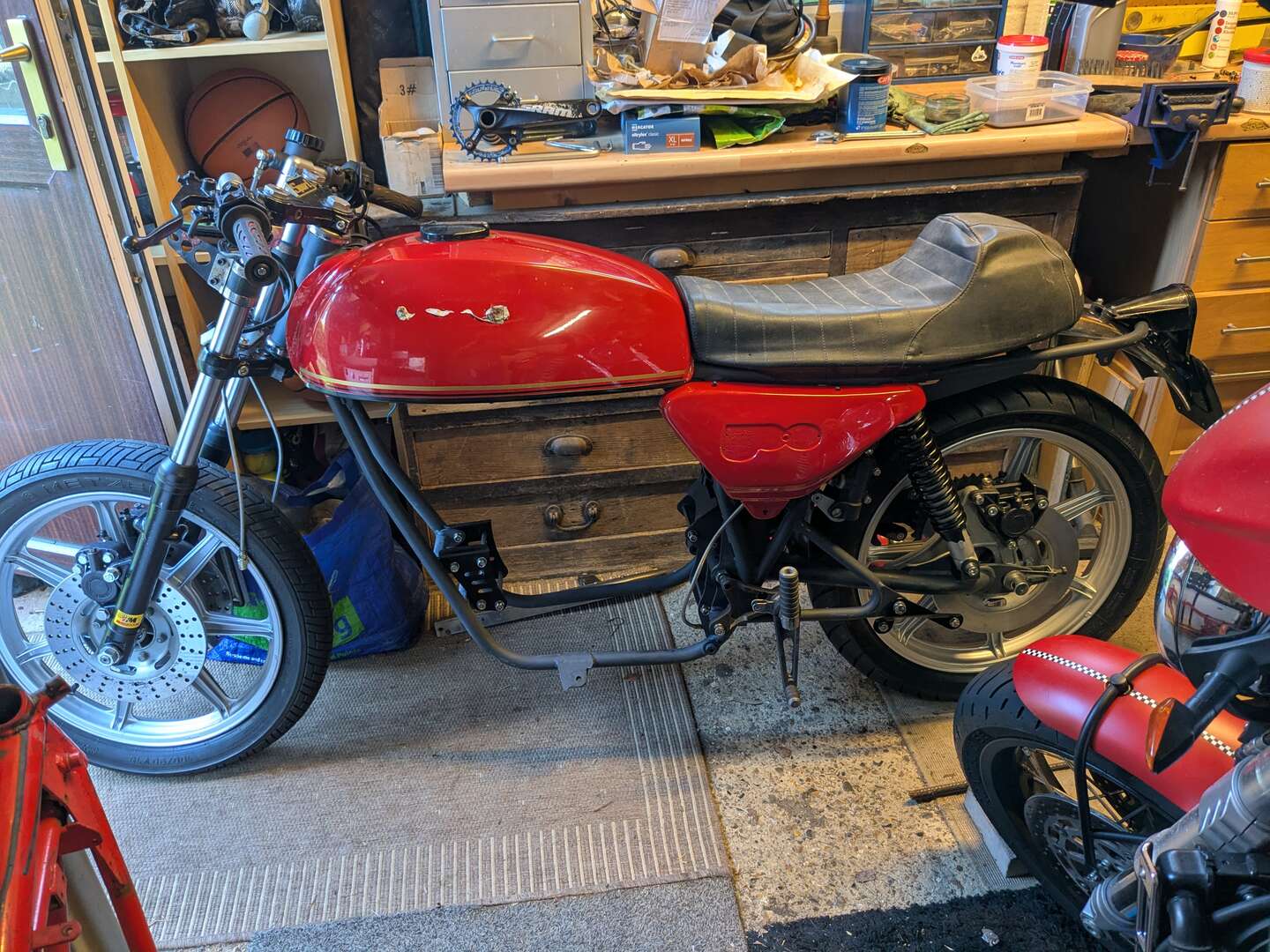

Not sure it's old enough, but en-route to Sicily, fab trip.  Quite a lot of bits and bobs done to the bike, notably switching wheel size to allow for modern tyres

Posts: 12562
Now to get yourself a 125 and practice, practice, practice.
That was the origin story of this thread cvilla. See the first photo!
I got it running on Saturday, but it cuts out on idle so still a little bit to do, starting with cleaning the Carburettor jets I think because it had been run around with no fuel filtration for a white.

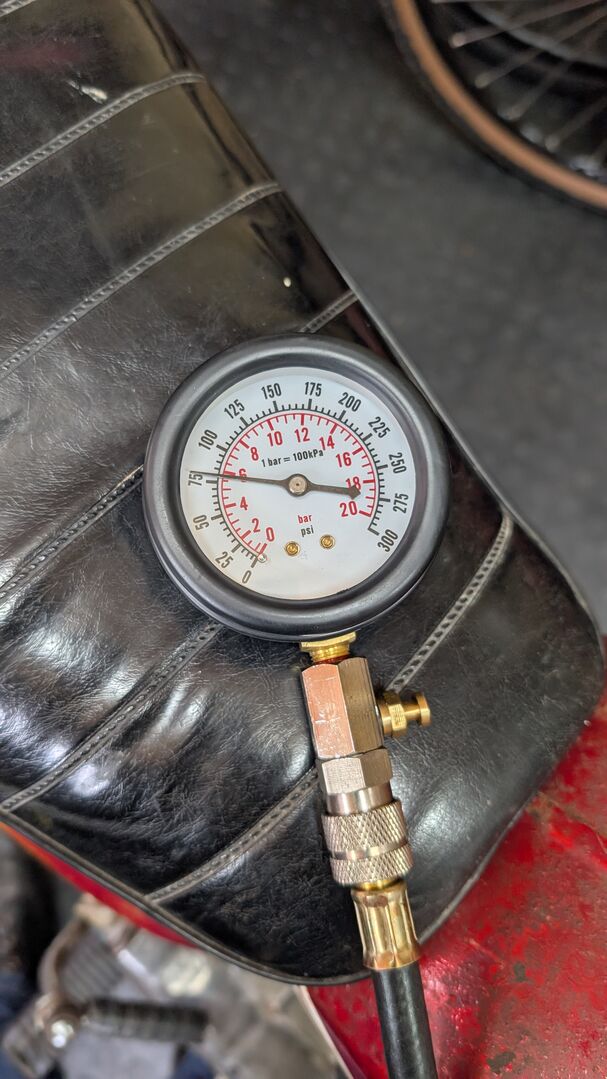

Posts: 12562
Well we've managed to **** it. Low compression put down to badly scored bores. Top end rebuild, I can do that, not horribly expensive and a new learning experience. But while investigating have managed to smash the kickstart mechanism, which means a FULL engine rebuild and who knows what other horror's may lurk. 💸💸😭
But after already spending a little chunk of cash on it, would seem a real shame to just scrap it, so I really dunno what to do.

Posts: 502
I also started with a Honda 125 (2016 model) not looked after but functions, until exhaust valve broke a bit off, no compression, que a re-build (no kick start thingie tho'), all part of motorcycling experience 😉
Also 125 bikes do sell, either for commuting, cheap motorcycling or for learners, so worth it if you want to tinker.
