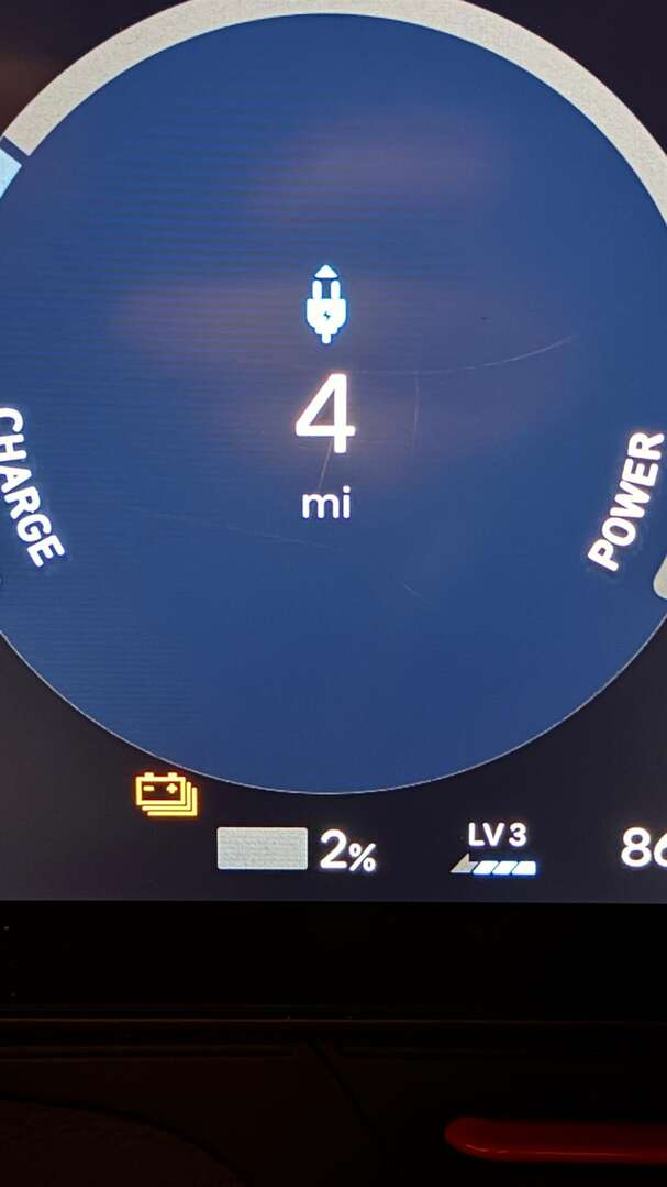

Arrived at destination with 54% which suggests we would have arrived with 4% had we not charged. That would have made for some very twitchy bums around the detours that Google maps /electroverse hadn't factored in.
4%? Try harder!  This was my car after  a 2am winter drive back from Glasgow airport with 5 people in the car. This was at the wrong end of spending 18 hours travelling, with the last 40miles being on a road with no charging infrastructure.

4%? Try harder!
Pass. Wouldn't run my ice tank that low either.
