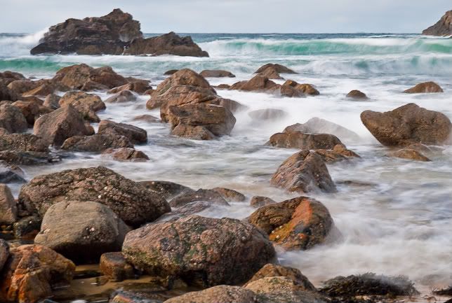

I did some slow shutter speed shots up in the Hebrides a couple of months ago. I used a B+W 10 stop filter in 52mm thread size. You can get step up rings for pretty cheap if you need to use smaller lens thread sizes. Has a bit of an orangey cast to the pics.
[img] ?t=1273393996[/img]
[img] ?t=1273394138[/img]
[img] ?t=1273394455[/img]
Another option is the LIghtcraft fader ND - which ranges from 2-8 stops via a rather funky dial. Not had a chance to use it much yet but it does seem to create some vignetting.
Posted : 09/05/2010 9:42 am
Firstly, on the evidence of your first shot, I'd get your sensor cleaned ๐Ÿ˜‰
As for filters, if you are serious, the only way is Lee. Yes they are pricey, but they are much more neutral than any other make I've used. It's a slot-in system like the Cokins, so you only need to buy one set of filters, and just get a different adapter ring to make the holder fit on different lenses.
