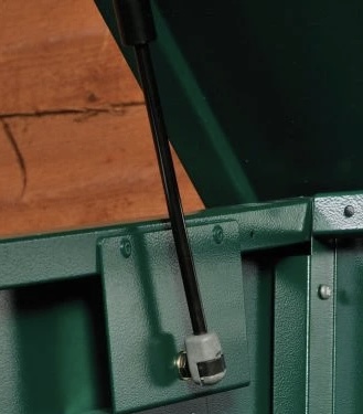

 IMG_7580.jpeg•••••••
as a starting point in your search, these gas struts came as standard with my Asgards
https://www.asgardsss.co.uk/replacement-access-gas-lift
