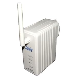

I recently added one of these.
They have an ethernet port (for your TV/Xbox) and work as a wifi access point so it extends your wifi network at the same time.
Google Solwise WiFi Extender.

Not sure what you need to do for the wifi extender, presumably set up the security keys on it for your network etc., wouldn't think it'd be a chore though.
All I had to do was give it the same encryption key and SSID as my existing access point.
