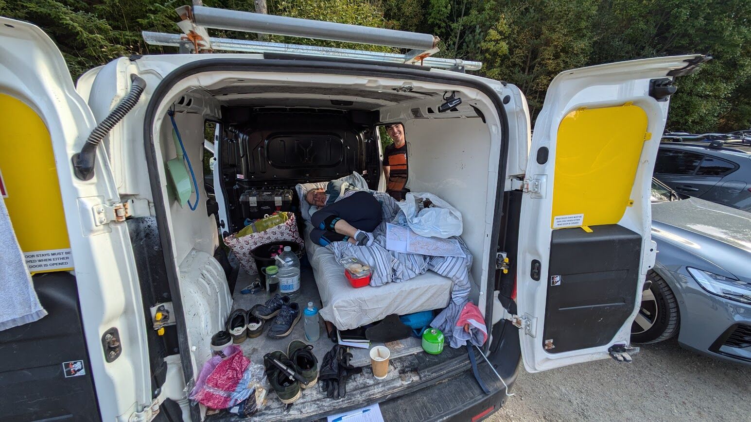

Having seen 'cheap' van that cost £4k, be very very fussy. This was my lads van - £4k cost, £1200 to convert. Took him to Italy, Austria, Germany, Switzerland and France for a couple of summers.
However, first MOT cost £700 of brakes and welding, second MOT cost £400 of welding and he was told to bail before next MOT. So we did.
And this was the best van we found in a few months...
https://www.flickr.com/photos/matt_outandabout/albums/72177720300543524
He then moved to a Combo LWB bought from a local dealer for £3k. It was much better, dealer warrantied the turbo when it blew up a day after purchase(!), and my son did a year 12k miles with no issues. MOT had an advisory for rust and nothing else.
https://lh3.googleusercontent.com/pw/AP1GczPj1xjdj9vMPK2rNgdcxYlsXLXaydagM68GpV5GS5XsvWnfvCF8OQPw0enEcSJApkIwxkygawQVFklA6h2TvsWbyK_dsBSU64Y1JNE_N8eSd19ZPbwv=w2400 PXL_20240921_130140907.jpg

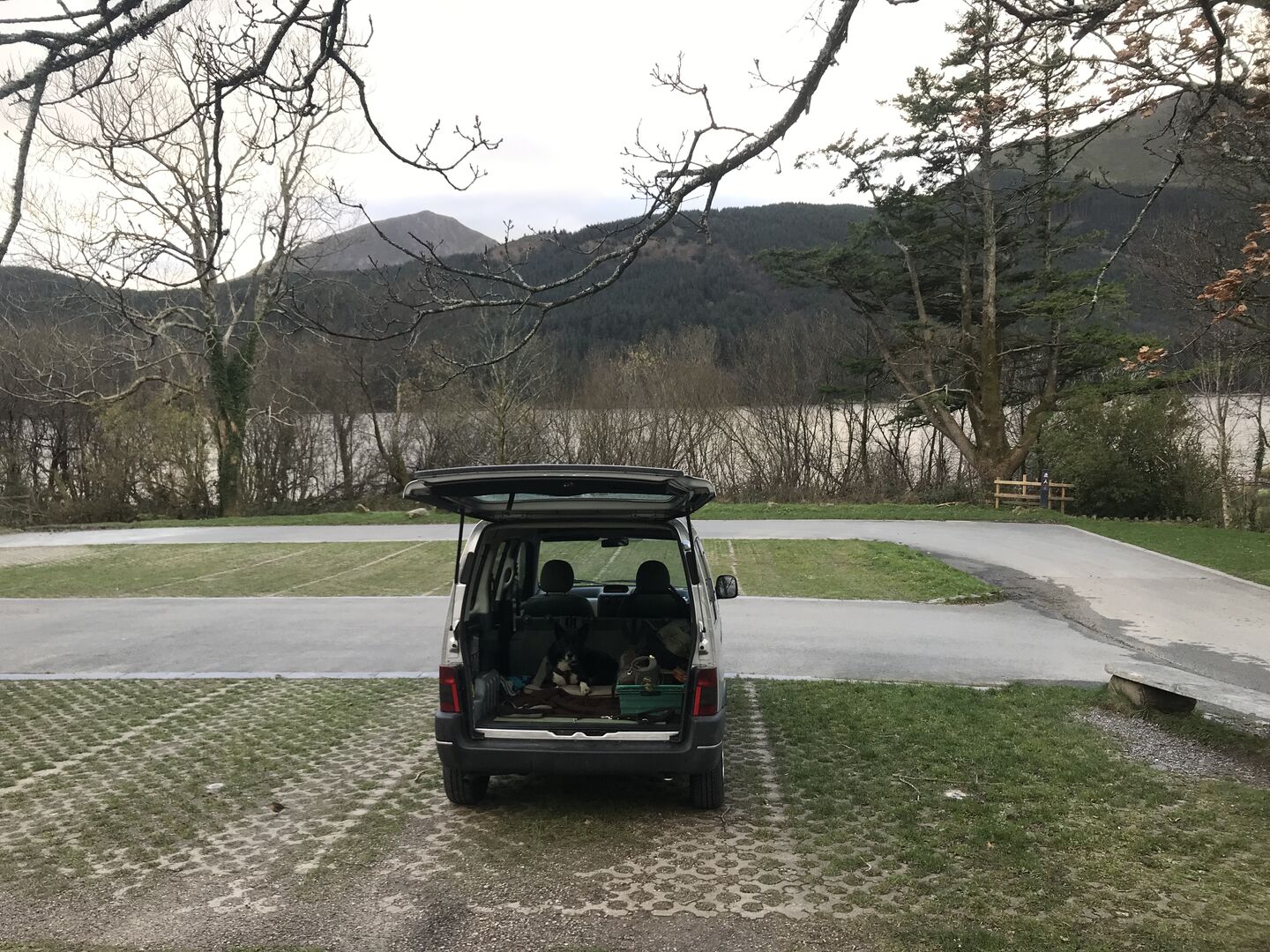

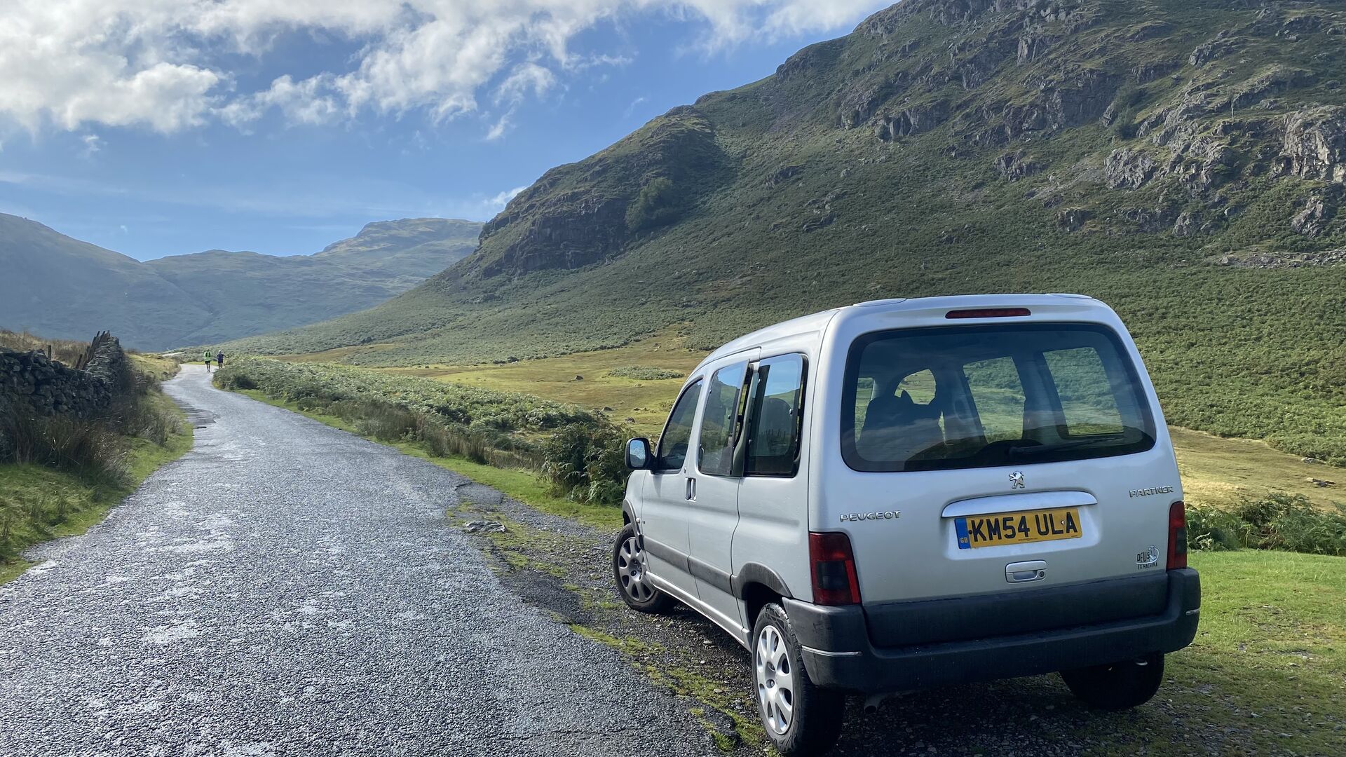

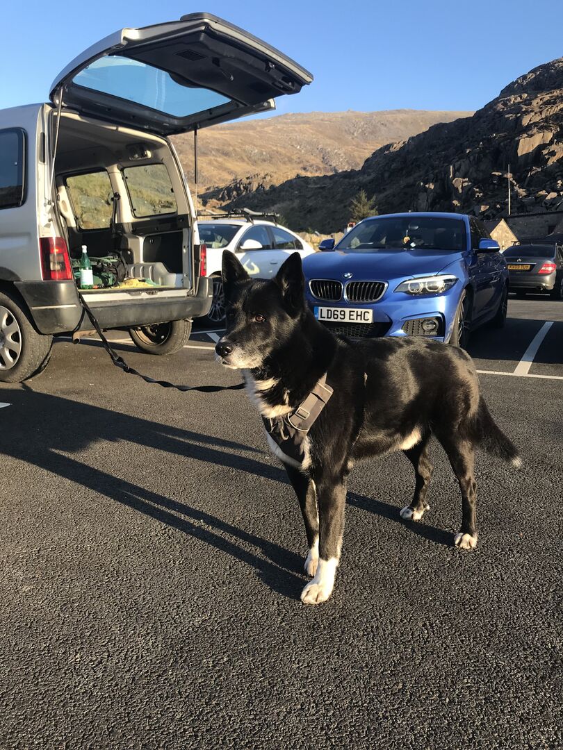

 IMG_0759.jpegIMG_2642.jpegIMG_1212.jpeg Avoid WAV’s like the plague - always look at Autotrader photos and look for the cuts in the rear bumpers. They are cheap for a reason.
Cared for non thrashed vans are as rare as unicorn tears - look at the MPV equivalent instead, Berlingo, Pug Partner, CaddyLife etc. Id be surprised if you could get a Caddy Life for the £5k you mentioned that isn’t on moon mileage. MPV tailgates are better than van barn doors.
1.6 VAG engines (I don’t know the code) are notorious for eating injectors.
I’m biased but my M59 2.0hdi Berlingo is old school Bulletproof, galvanised, dirt cheap for parts and economical. Lots of people add a Campal or Amdro boot jump and a rear awning for a <£5k micro camper. The later 1.6 PSA group diesel started off shit but got better. A late as possible B9 XTR spec Berlingo/Pug Partner would be a better/safer choice. In fact the one you linked to that I’ve now opened is pretty much perfect! There are lots of FB groups for Berlingo/Partner micro campers.
I went all over the UK on doggo adventures.

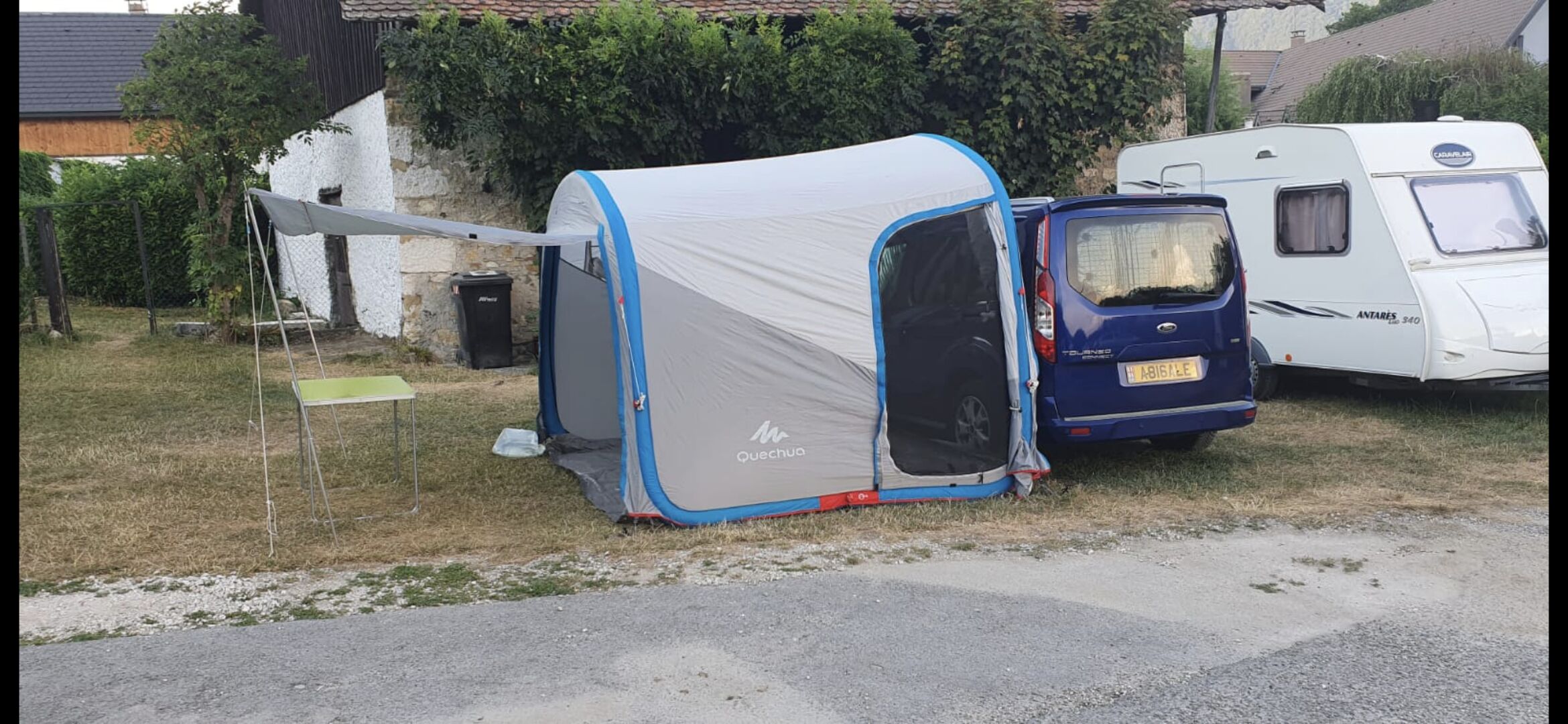

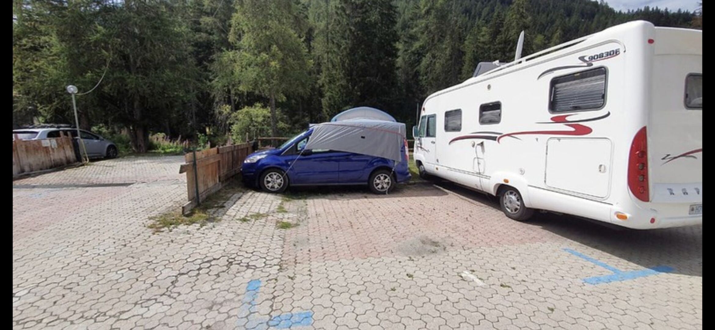

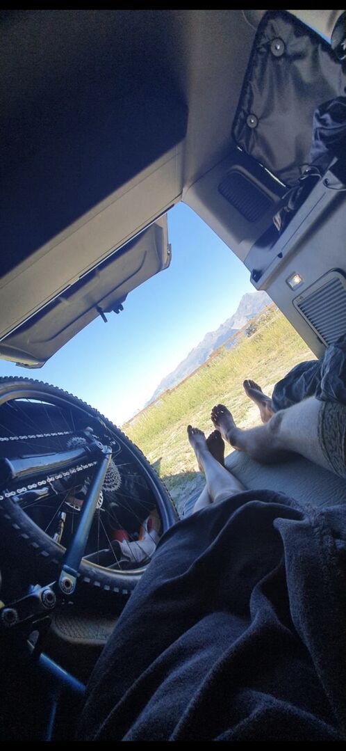

Daughter did a load of travelling around the UK and Europe in a Tourneo Connect with the rear seats out. Mattress inside and room for bikes. Cooking and relaxing were in a Decathlon drive away awning
Screenshot_20260527_200715_Gallery.jpgScreenshot_20260527_200610_Gallery.jpgScreenshot_20260527_200634_Gallery.jpg

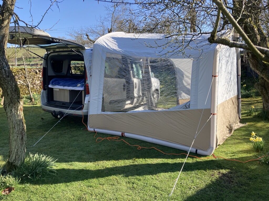

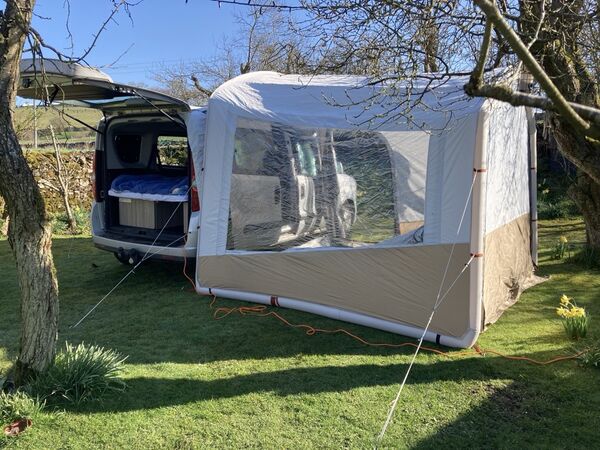

We have had a Fiat Doblo mini camper with a kit purchased from Redcote for about five years. Our daughter uses it a lot on her own but we also use it as a family for some things. Something bigger is difficult to insure for a 19 year old so we have stuck with it. We originally got it as a supplement to a small caravan so that if we were staying on Orkney mainland we could stay odd nights on some smaller islands etc.
I have adapted the kit a bit so that it is easier to use for three people as a day van and increased the storage by removing a couple of the rear seats. For two or three people we use the Decathlon air awning and a roof box. The air awning has a bedroom in it or it can be a big sitting and cooking space.
It is a surprisingly nice place to sleep and stays really comfortable and warm and insulates from noise well with only thermal blinds on the windows. If I was going to replace it I would get an electric Berlingo XL

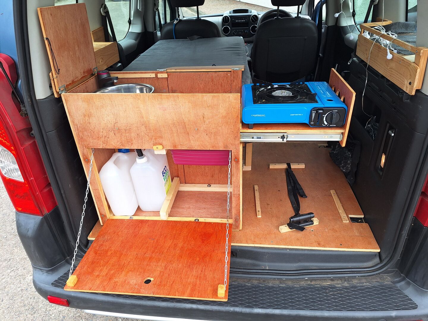

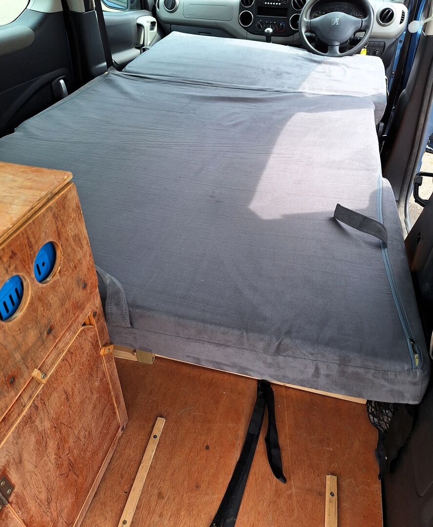

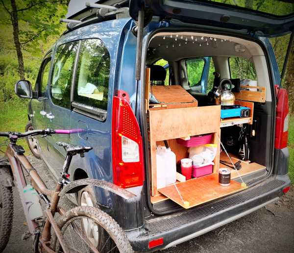

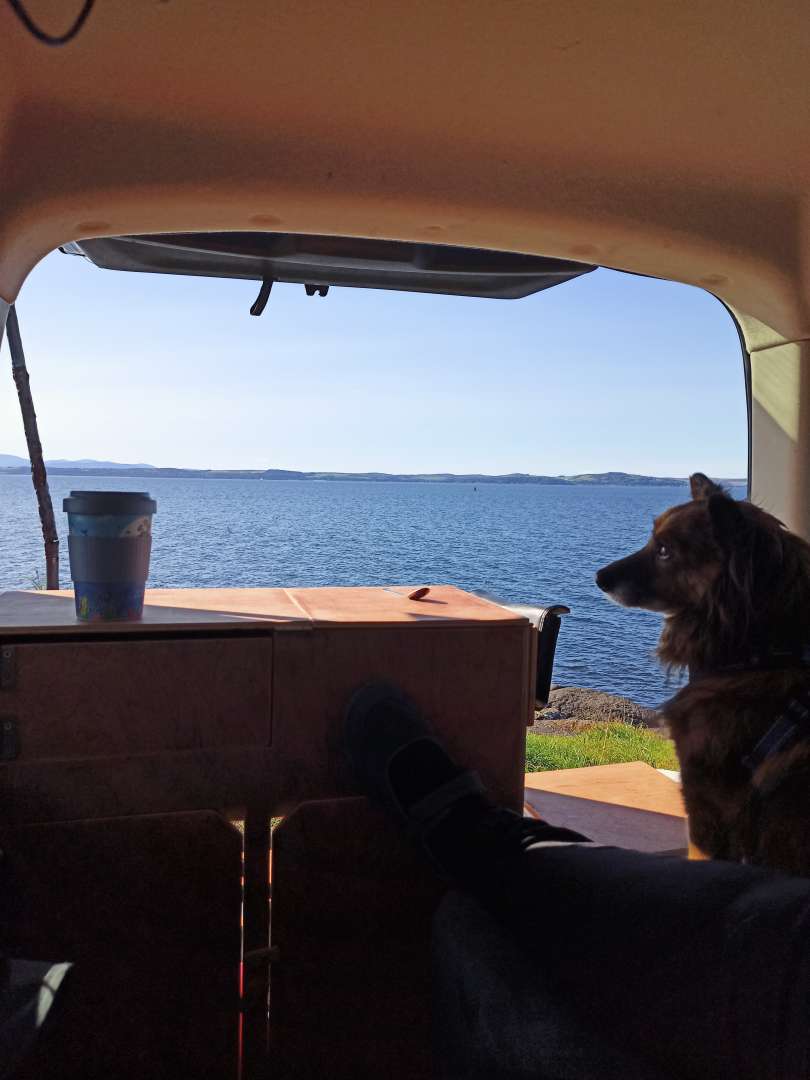

Had a Puggy partner for a few years, sold it last year though as we weren't using it as much as we'd liked due to our dog recovering from injuries and not traveling well.
I removed the rear seats, ply boarded, but left a flap so a 3rd seat could go back in. built a compact kitchen, and a pull out bed configured to extend over the drivers and passenger seats, so I could cook and access the kitchen bits either from the end of the bed, or from outside. had a drive in awning, but never needed it. we did have a roofbox though, which was essential for  more than a couple of days out.
didn't line it or anything as I wanted to be able to easily convert back to a car if needed.
oh and tailgate. though I think I'd have probably adapted something if it was barn doors, but having solid rain protection (with side wings attached to the tailgate) was excellent.
bought it for about £3.5k, sold it for £3k, so happy with that and gave me a bit of experience building stuff. only issue we had was one of the injectors, but once sorted it was fine. checked MOT the other day and it's still putting the miles in with the new owner. 🙂
now that the dog is better we're eying up something slightly bigger...maybe for next year.
20250621_121848.jpg 20250621_122605.jpg IMG20200904062923.jpg 20240819_142202~3.jpg IMG20200926135149.jpg
