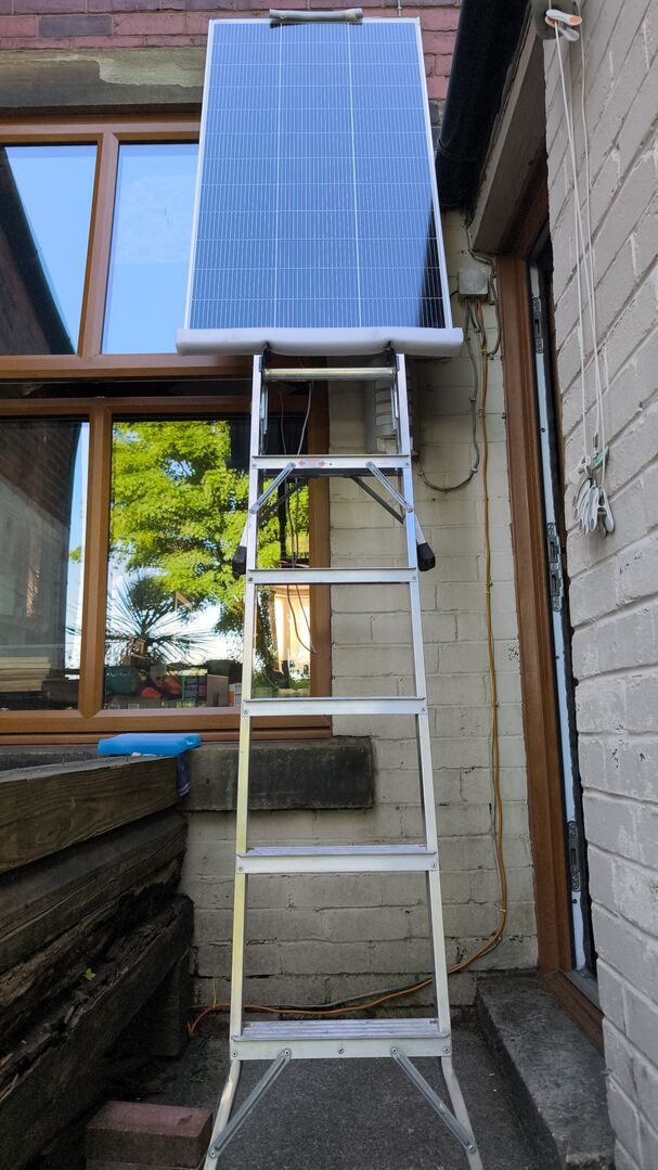

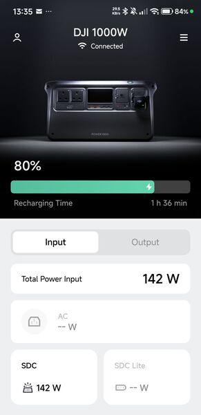

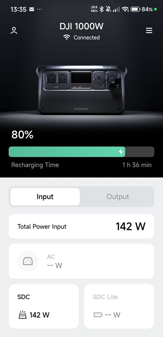

In the sunshine today a 200w 16 busbar (I think) solar panel has been charging my DJI power 1000 battery.
I have been adding around 400w a day with the panel given the shade in the morning and from mid afternoon.
I have changed my panel location from this on the ladders, to on my roof. So tomorrow I may get a bit more power 🤔
The 142w was from the roof.
On the roof.

A DJI mini 1000 for £450 and 1 rigid 200w solar panel for £70-100 should be able to charge up the robot mower. It will probably be a low power sub 100w charger?
You might need to buy an xt60? extension lead but they are reasonably cheap.

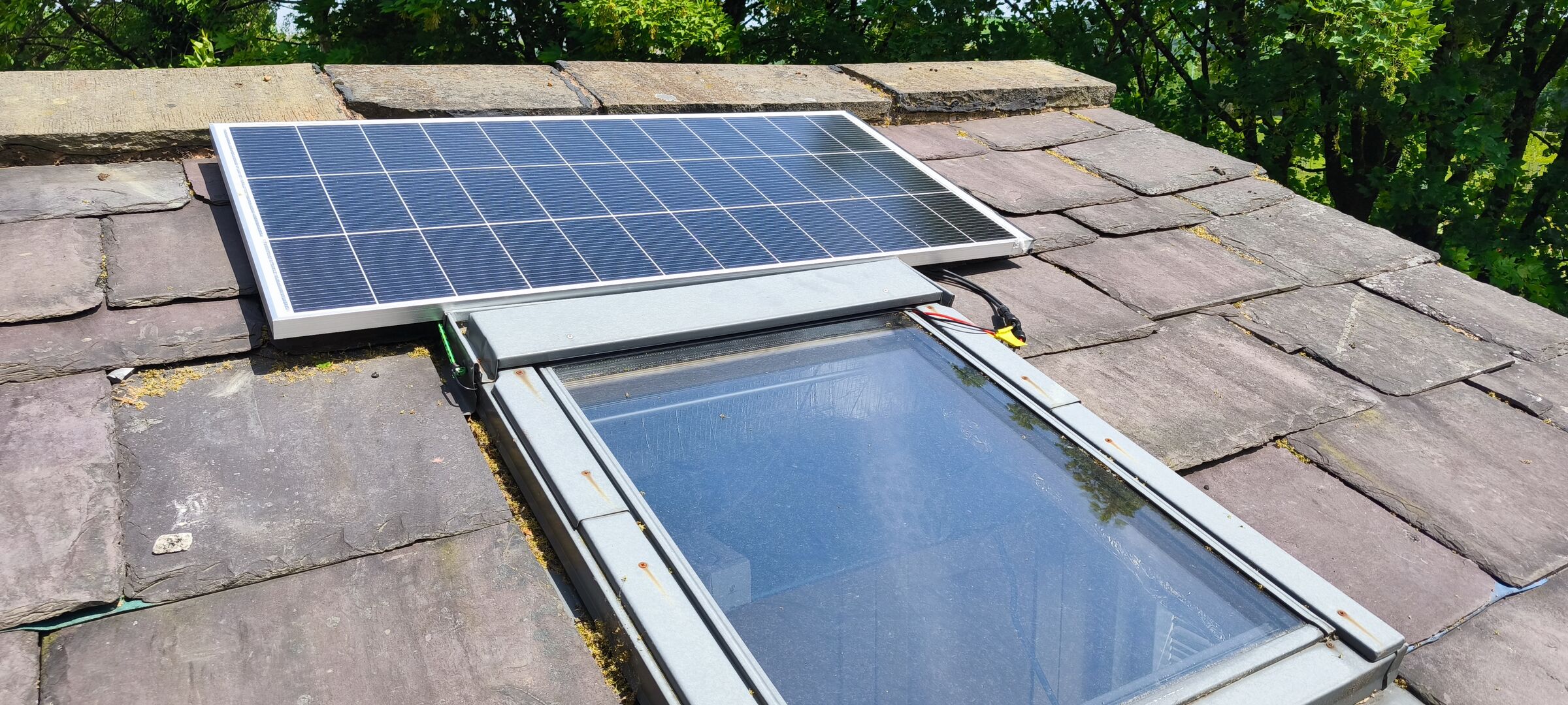

Posts: 2153
Posted by: bruneep
That slate roof is making my teeth itch 😬
It was even worse when I moved in!
The slates were all over the place. I did a reasonable job repositioning them, then i stuck a skylight in.
Next repair will be a full solar roof.
Posted : 27/05/2026 10:25 pm

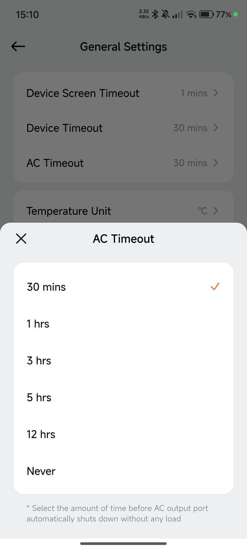

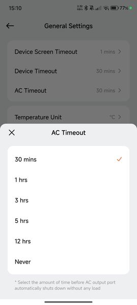

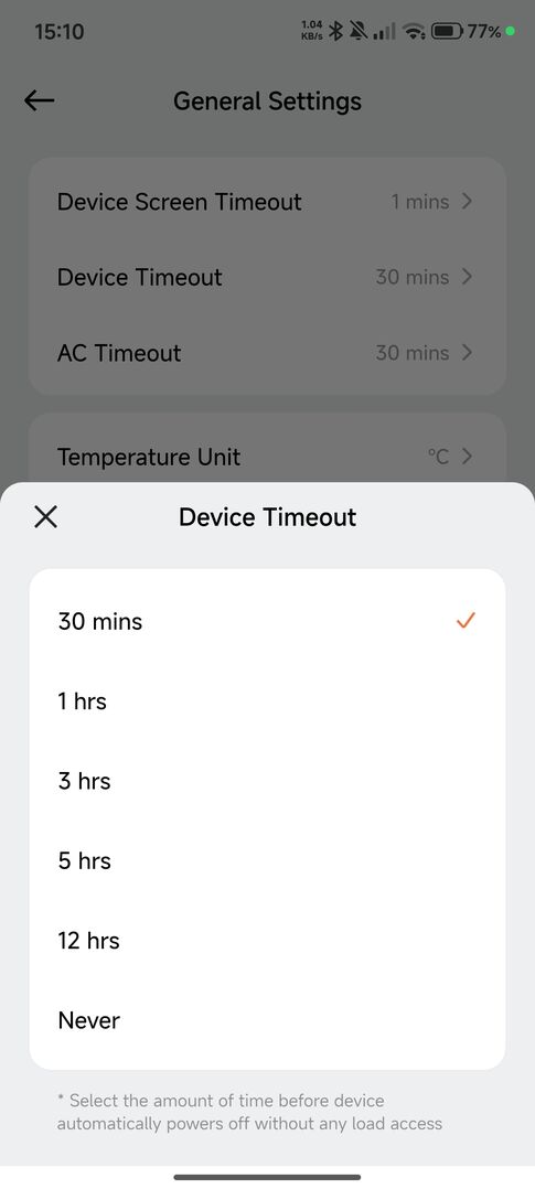

Posts: 9905
Only issue with the solar and powerbank, yes it will work, but my powerbank will power down after a couple of hours, so will switch off the 12v or 240v if it's not being 'used' - e.g. if the mower is fully charged, the bank will power off and not power back up until you switch it on.
May be much cheaper to buy a mower and pop round once every couple of weeks. That's what we had to do when the gardener let us down for MIL.
Posted : 28/05/2026 12:50 pm
Posts: 2153
Posted by: fossy
Good point.
The DJI I own can be set up so that it shouldn't power off at all. There would be a constant drain from the inverter being on all the time and maybe that would reduce the lifespan of the power station? Screenshot_2026-05-28-15-10-34-100_com.dji.home.jpgScreenshot_2026-05-28-15-10-41-510_com.dji.home.jpg
