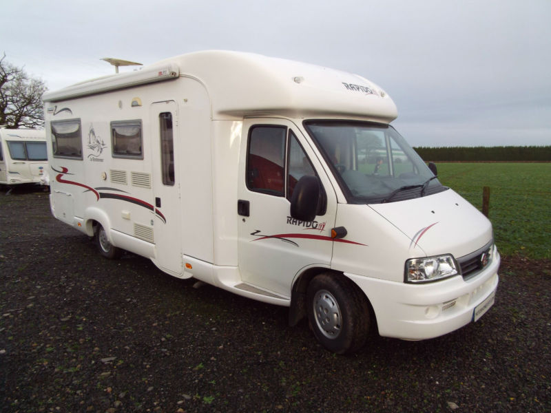

We have a 7.2m long motorhome and it's possible the council will introduce permit parking with a max vehicle length of 6.5m.
Drive is 6.5m long to the front of the garage (which is a decent length, used for storing bikes and crap and has a large kitchen behind it). Garage is single storey, attached to house on one side, wooden ply roof with a ashfelt cover, brick and block walls. square front with up and over door. The drive is about 40cm wider than the motorhome where it woudl go past the side of the house.
So we have a number of choices;
1) replace the motorhome. Woudl rather not - we like the one we have, would lose money changing etc
2) put motorhome in storage - cost is significant annually on the south coast, we'd use it less if we had to drive for half an hour+ to get to it.
3) Make the garage a bit shorter and put the motorhome on the drive.
Looking ahow the things' built just working back a couple of joists , knocking the front end and a metre of sidewall down then rebuilding with the existing RSJ across the entrance, reuse door, tie into to existign brickwork and the side of the house etc.
Does this sound like a big job?
Should it be possible to just 'roll back' the existing roof covering and refit to the new front end?
Do I need building control?
I'd probably knock a couple of metres off so there's a bit of space in case we replace it with a longer model.

if you had the garage door open, would the front 70cm of the van fit in it (I guess depends on whether it has something hanging over the cab or not) - you could then build a partition inside it to store your other stuff safely.
Posted : 20/06/2017 2:07 pm
It might do, good thinking.
was thinking of putting it in backwards as the habitation exit would be onto the drive rather than into a wall.
I'd have to take the existing garage door off to try it I think as it hinges out.
Or I could make a frame the same shape and see how far along the cab it'll go!

Not so much the land values, more the "hey everybody look at my Huuuuuuuuge Campervan".
It does look nice though, happy camping. 🙂
As for where to park it, the partial boxing off of the existing garage front has legs, should be easy enough to put a roller shutter door further back within the existing structure, either on a wooden or steel frame since it won't be so well tied into the existing brickwork.
Posted : 20/06/2017 2:59 pm
Ah, yes. Only downside is that despite it's size we ended up with one without a 'garage' for bikes but it's defintely better than the beach hut we sold to fund it 🙂
I'll be measuring the orifice later to see whether I can drive into it. I think with the door and frame removed there'll be enough width and heifght available and then, as you say, it's a case of building a secondary entrance and maybe weather proofing the exposed structure.
Hopefully none of the neighbours will complain about us having a garage with a portico...

Technically if you partition I think you need a firedoor.

You could just move the door of the garage inwards a metre or so.

As for the garage - shouldnt be that hard , only issue might be is if your are removing a butress from the wall that could make the price a bit more.
id certainly look at putting the door up and seeing how far the van comes in nose first and seeing how that works
