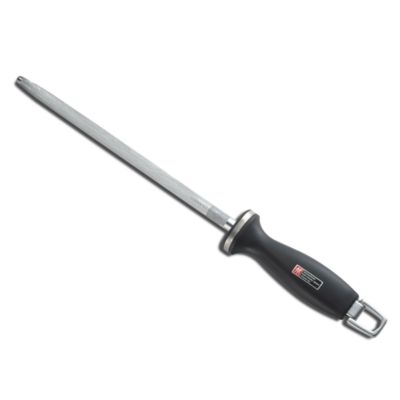

Posts: 13594
I just use a steel, takes a few swipes on each side and they go from blunt to dangerously sharp...
[img] http://s7d9.scene7.com/is/image/BedBathandBeyond/739910158842p?$229$ [/img]
