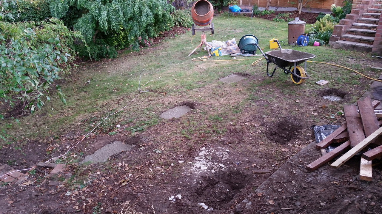

I had a sloping site, so used DIY concrete micropiles. 6" cardboard packing tubes as formers, post hole diggers to dig the hole. frame on top. still there 5yrs later.

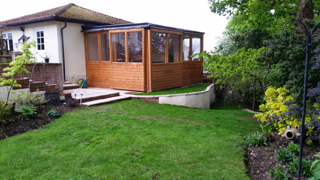

Footings for brick towers we about 18" deep and filled with concrete
four along the 4.8m side and one row in the middle of the 3.6m side. The back was bolted to the existing garage wall.
The cabin is 3.6m x 4.8m and the water in the hot tub is over 1 tonne. The curved wall with the grass is next to the cabin and does not extend under it. Still standing after many years and all designed and built by me 🙂

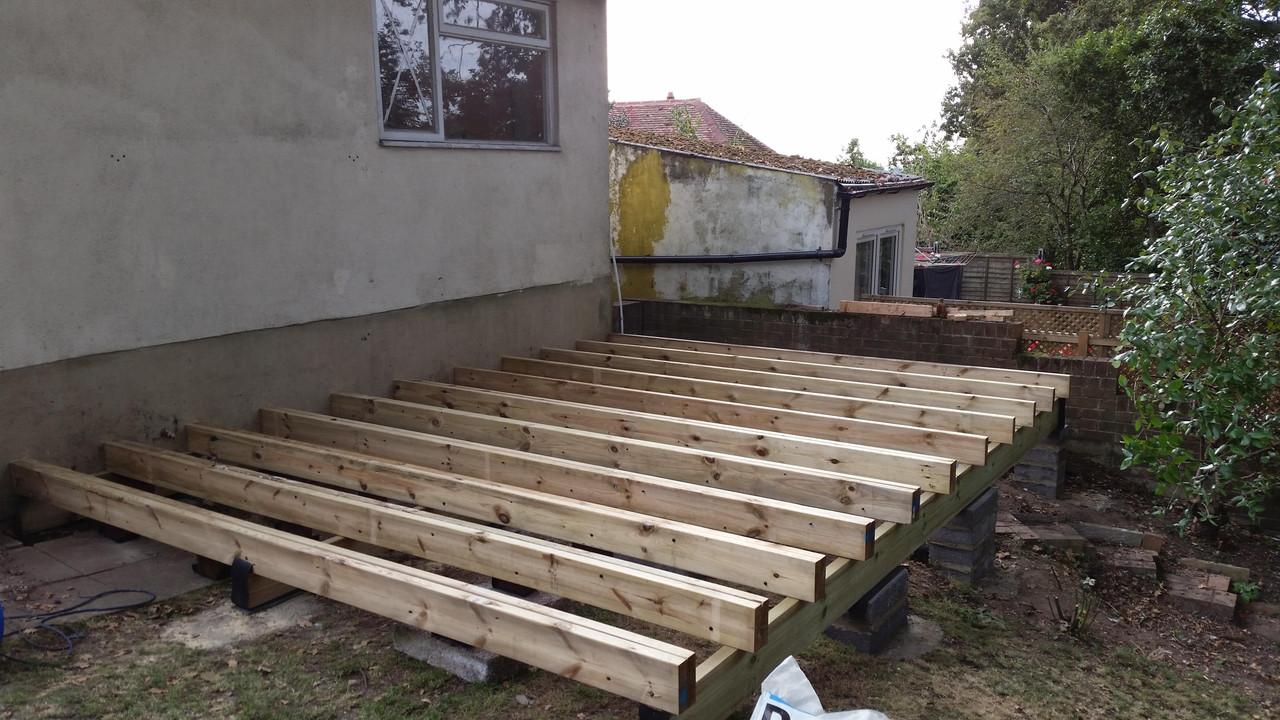

Mine is on a slope as you can see and there is a huge oak tree just behind the fence on the right of the photo. Ground is not clay though thankfully.

Partial depth self poured 'pads' would be my last choice. Sonotubes are designed to get below the frost line and provide a smooth wall surface so that they resist frost heave. UK frost line might only be a few inches though.
With footings, You also want to get down to undisturbed soil regardless of frost depth. At the side of the house where your foundation was excavated, you're most likely dealing with poor load bearing uncompacted backfill. same consideration with backfilled landscaped gardens.
I wouldn't be following WCA's approach tbh. Hopefully there's no structural fasteners connecting the joists onto the leger board and its just load bearing..
Looks like screw piles are just the ticket but presumably you still need geotech to spec the number and sizing?
