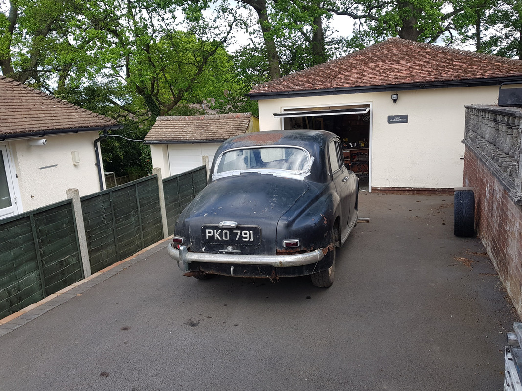

Aquasteel is great. I have some left over from working on this. A little goes a long way. It is basically the same chemicals as Bilt Hamber I think so choose either - both overkill for a lawnmower but you might end up buying a rusty classic where you can use up the rest.
Make sure you pour it into a cup and brush from the cup. If you start dipping a brush with rust in the bottle then the rust will fall in and the reaction will start inside the bottle instead of on the car.
