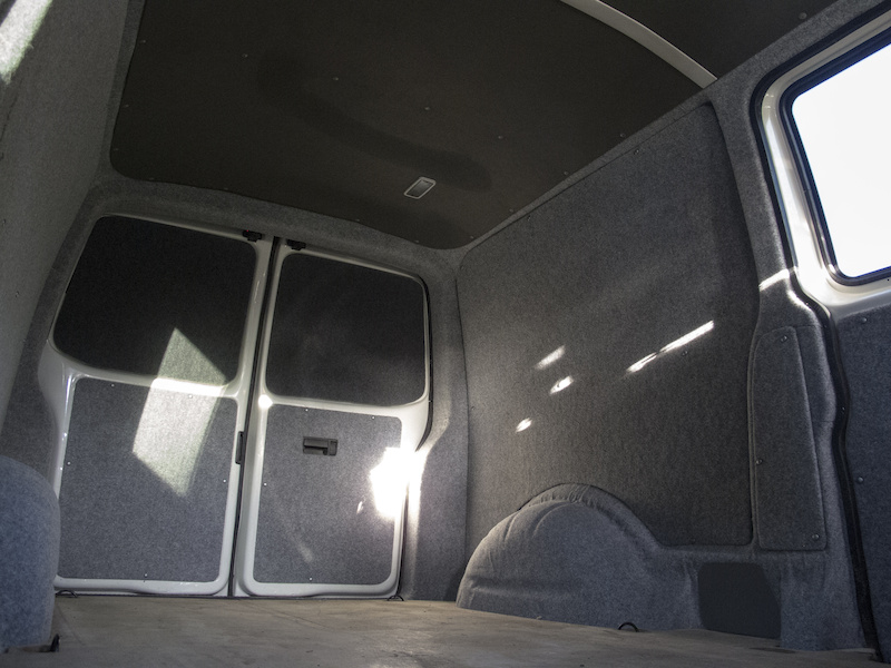

This is what the van currently looks like;
All the panels were flashbanded for noise reduction. Then layers of foil bubble wrap and rockwool stuffed in all the nooks and crannys. Topped off with carpeted ply panels.
There was a drastic reduction in noise as soon as I applied the flashbanding and it retains interior heat for a much extended period. It should have had a leisure battery, power points and diesel powered heater by now but as I said I was unexpectedly shown the door at work. So I'm stuck with a noisy, rattly, 3 piece, ply wood floor on top of bare metal.

1. Insulate if it's not already. I use silver bubble wrap on all surfaces. Then plastic loft insulation. Ply kit then carpet.do floor and roof as well.
2. 4 season synthetic sleeping bag. £100 well spent. Happily did -16 a few winters back on a snowboard trip.
3. Plan a layout. Even in swb transporter you can make a small bike boot for a few bike then you have room for a bed. Sheet of ply on batons if you want to keep it simple.
You need to put a bit of effort into the basics to make it warm and comfortable. If its cold or a mess with no storage you simply won't use it and it's a waste of time.
A blind or curtains to seperately cab area from back makes it cosier and warmer too!
O and buy trim fix high temp glue for everything or all your insulation and carpet will come off in the summer!

Just seen your latest picture! Sleeping bag and fixed bed will sort it. Go outdoors do some good synthetic ones for £100
