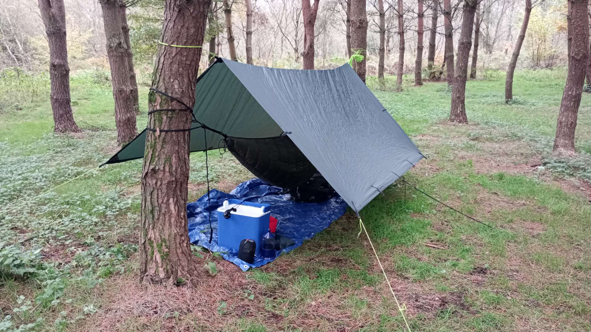

I use mine a lot. As a scout troop we have pretty much given up on tents and moved to hammocks.
My kit:
DD Hammock
DD 3x3 tarp
Underblanket - Can't remember what make, but not DD
Cheap ebay "blue tarp" to put on the floor so you have somewhere dry to put your boots etc
Paracord for the top line
Couple of bungees if you need to get tension on the tarp
Cheapo carabiners to hang you bits and bobs from the top line
30l dry bag to stash it all in.
Will only use a tent if there is nowhere to sling a hammock. IMG_20241102_122028.jpg
From your pic and description, it looks like it's more 'stuff' than a 2-berth backpacking tent (hammock, tarp, underquilt, tarp/sheet on floor) so doesn't pack down as small as that tent and it looks like it takes about the same amount of time to put up as that tent.
So, genuine Q - what's the advantage?
Posted : 09/07/2025 2:53 pm
Posts: 23313
I sleep better in it.
It dries quicker.
Doesn't get muddy.
No arsing about folding it up. Just stuff it in the bag.
Bigger than a 2 man "coffin" tent, but smaller than my personal 3 man tent, and quicker to set up/take down.
Biggest advantage for me is that I don't have to sleep on the floor or crawl about on my hands and knees setting it up.
Posted : 09/07/2025 3:07 pm

DD all the way for me. For a groundsheet I use a square of secondary/tertiary glazing film, weighs nothing and lasts a week.
Looking at the photo HTS posted, it's OK to tie the ridge line for the tarp round the tree, but you should really use webbing for the hammock. With your weight in the hammock and the force being amplified by the angle, rope is liable to cut through the bark and kill the tree.
Posted : 11/07/2025 7:17 pm
Posts: 5527
Alton Goods make great tarps. And lots of other very decent gear.
I've got an old desert cam british army tarp which is very useful for providing wind break or for a little drizzle shelter while you're sat poking the fire.
I wouldn't use Paracord for tarp lines though. Bankline is better as it doesn't stretch when it's wet.

Never noticed the paracord stretching sufficiently for it to become an issue.
@greybeard it isn't rope. It is the flat "tape" that comes with the hammock. About an inch wide.
Posted : 14/07/2025 8:17 am
Posts: 4209
Posted by: Harry_the_Spider
Apologies - no criticism intended - it looks like rope so it was for clarification for newbies to hammocks
Posted : 14/07/2025 8:49 am
