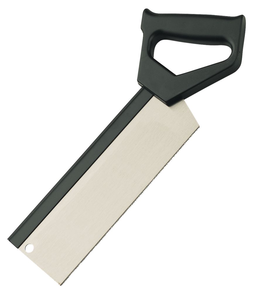

This worked out well in the end, £12. A bit of faff in places, due to access, but the did the job when coupled with a bit of force.
