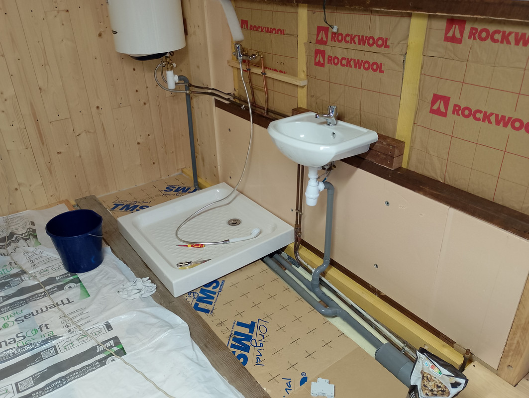

I know Italian style walk in showers are fashionable but my advice is don't, it'll leak. If you really want a shower then a quality ceramic base on a plinth with an arm size access hole and with exposed waste plumbing with access for cleaning at bends will serve you well. Box it in either where it is or under the floor as martinhutch suggests, but a walk-in and running through joists will mean a demolition job if there's a leak.
I'm working on one at the moment. The big beam you can see supports the joists which leaves a clean run for the plumbing. The walls are the next step then the floor boards which will be removable for access to the plumbing.
