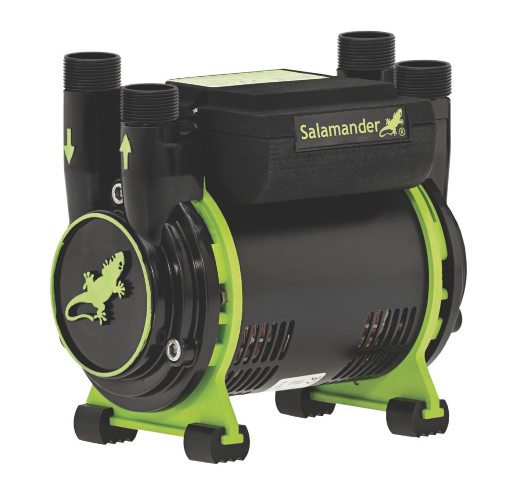

Fitted a Salamander pump to a similar set up to the OP's last year and should have done it years ago.
[img] https://s7g3.scene7.com/is/image//ae235?src=ae235/20423_P&$prodImageMedium$ [/img]
This feeds one shower for just over £100 and was simpler to fit than something to boost the whole system.
