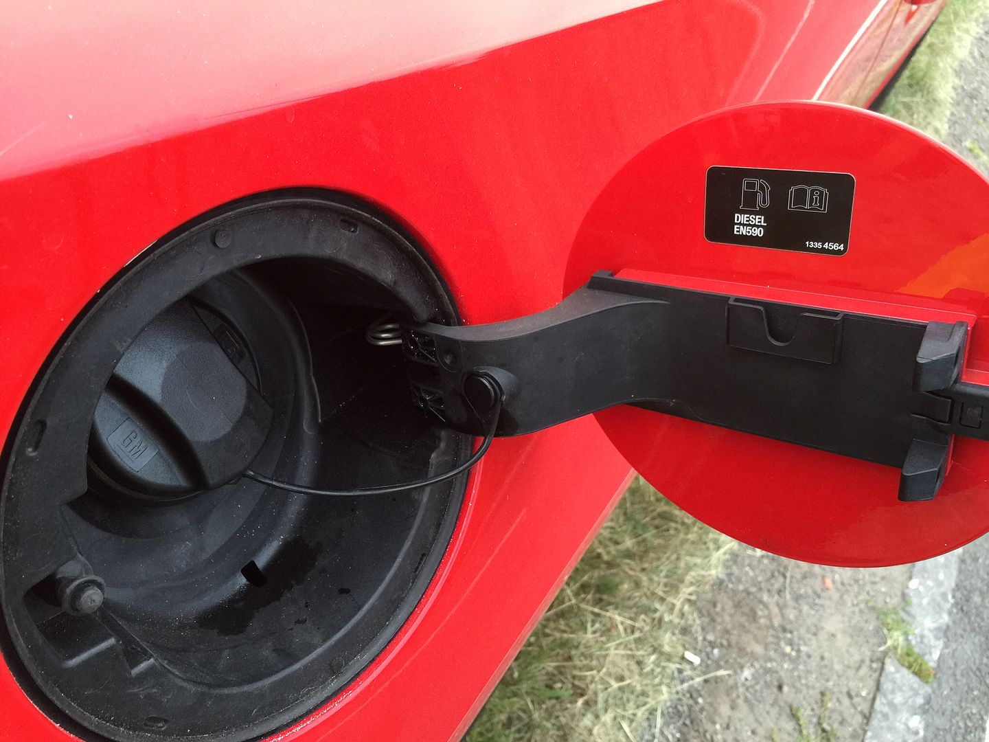

...she has now filled the almost empty tank with petrol instead of diesel. And yes, then driven it until it started spluttering.
So, recovery are on there way to fetch her and the car home. It's only two years old with three years left on the warranty, so my first instinct is to get Toyota to sort it out try and maintain the warranty.
Can't see misfuelling as a specific exclusion on my policy, but that will be her third claim in three years if we go that way. Let's have your guesses for the costs for Toyota to fix this.

Petrol in a diesel? Diesel is oily and acts like, erm, oil, and she's just stripped all that out of the engine. That'll be expensive.

I was under the (perhaps mistaken) impression that putting petrol in a diesel car is less calamitous than putting diesel in a petrol car. ?
Posted : 15/05/2017 10:31 pm
Posts: 1083
I think that was true in the olden days before diesels got very complicated.
It still had about five litres of diesel in, and was driven 3/4 of a mile until she pulled over because it was a bit juddery. Might that be sufficiently not-too-bad that draining/flushing etc. might be enough?
I seriously doubt it, driven for 3/4 of a mile on a practically full tank of petrol it's gonna be a new engine as "[i]it was a bit juddery[/i]" is indication of partial engine seizure and major expense

My missus did it. She only slapped £15 quids worth of petrol in a diesel. Drove up the motorway till it spluttered.
Was flushed out and £30 worth of diesel put in. Ran fine afterwards. 12 months later still runs fine.

It will be fine, modern diesel isn't very lubricating since they took sulphur out of it so fuel pumps are designed accordingly.
Drain it, flush diesel thru the system, start it up.
The fuel pump and /or injectors will probably have a reduced life compared to not misfueling it but you might have to change them at 100k miles rather than 150k. It sounds like your Mrs would have written it off way before then anyway.
A good mate did this with a nearly new L322 Rangie - full tank of petrol drove till it spluttered to a halt. Flushed, refilled fine ever since. Just changed main HP fuel pump and an injector at 130k miles.

That's what I'm hoping RNP. Apparently, about half a mile along the road, it started to judder 'like I was in the wrong gear'. Her initial thought was that it may have been caused by one of the hitch-hikers she had picked up at the petrol station 'somehow getting in the car wrong'. So she pulled over and phoned me for an over the phone diagnosis. At this point the actual cause was discovered. The car is outside the house now, and I will go to the decent local independent in the morning.

I wouldn't be going to Toyota. You'll probably have to pay as its user error, and they'll have you wrapped round their finger as its a newish valuable car, and end up paying for loads of new components 'just in case' and a voided warranty on anything fuel related in future.
Take it somewhere local, get it flushed etc, if something breaks in six months, thats the time to replace it. (whether you claim you were 'just driving along' or come clean and pay for it)

I would get it drained , then add 5ltr derv and run it for 2 mins at idle then drain again. Then refill and try it.
I am not a mechanic but if it were me thats what I would do.
Should be fine mechanically, juddering is just pre ignition as the petrol was detonating on compression .At least she stopped quickly enough and didnt try an italian tune up.

I filled my diesel Passat with petrol a few years ago. Drove it until it cut out before I realised. Cost me about £150/200 for the tow and flush iirc at an independent (car was out of warranty anyway). I was more annoyed at the full tank of petrol wasted

Wife did it in our diesel. People who towed it away sorted it at their depot.
Just drained and ran through as above, no parts needed

Local garage will pick it up later, drain it, flush it, clean the filter etc. and get it running. Guy said the problems can manifest themselves in 5k miles or so rather than immediately as the petrol strips some sort of coating from the pump.
Posted : 16/05/2017 7:23 am
Drain add new filter refill and fully bleed system to injectors before cranking. I'd imagine Toyota would void the warranty on fuel system so if it did have problems later it would be on you.
That's what they're going to do.
Just have to take my chances thereafter I reckon.

The biggest problem is the filter disintegrating and hitting the injectors apparently.
They're going to change that. I read on one of the posted links that the lack of lubrication can lead the pump to wear so swarf gets in the injectors. I'm hoping that the short distance travelled and the suggestion that diesel is not as lubricating as it used to be so engines don't rely on it so much goes in my favour in that respect.

Posts: 33604
I stuck £18 worth of diesel into a petrol Astra GTC last year! I know that the nozzles are designed to not fit, but I was forced to park away from the only empty pump, and I could just get the nozzle to touch the outer edge of the filler hole.
My other excuse, and the one that meant I got away without having to cough up the £250 penalty, was the fact that the filler cover had a black Vauxhall label stuck to the inside that clearly, and quite unequivocally, said 'Diesel'!
Go figure, as they say somewhere.
