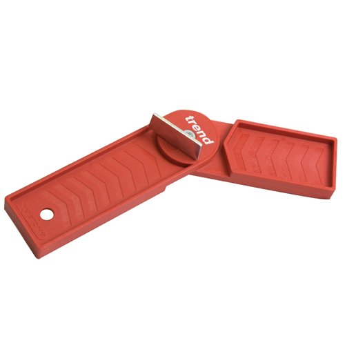

This Trend angle finder is the shizz. Wang it around an angle and the metal bit in the middle automatically splits the angle. Align your blade with it and boom... Perfect mitres and shit.

The one Festool tool we have at work, I fitted my own handle on the edge where any sensible company would normally put it 😀

Think you have sufficiently put me off a table saw, the plan was to use it outside under the porch. I have a sliding bezel but that trend angle finder looks worth a purchase.
