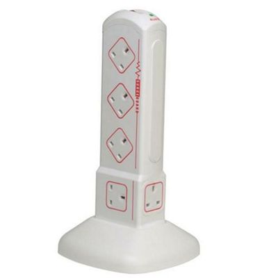

Follow up to this: bought some of these powerline things, and they work great. One thing though, in the instructions it says not to plug them into a multiplug but directly into a main socket at the wall. Is that a hard and fast rule or is it OK to plug into a multi plug type thing? It's a tower thing a bit like this...
[img] https://tesco.scene7.com/is/image/tesco/573-2855_PI_1000013MN [/img]
...which will no doubt horrify and offend in itself ๐Ÿ™‚

Posts: 43897
I've used them in multi plug things and they've been fine.

Posts: 181
Cool thanks. I've given it a whirl anyway, just didn't know if it caused them to misbehave or whatever.

Posts: 43897
I've never done any back-to-back testing to see if throughput is affected. TBH mine have been plugged in and switched on in my current house for 4 years and I never really think about them. They were 2-3 years in use before we moved too.

 xora
Posts: 954
I dropped about 10Mbits from having one in an extension. As the average about my flat at the time was about 140Mbits that was not a huge loss.
But you get ones with mains pass through to you can plug the multibar into them and not the other way round if it does become an issue in your place.

Posts: 181
Aye I know, just not convenient that way round, which no one will believe I know ๐Ÿ˜‰ Longer term is to have some plug sockets put in across the lounge to alleviate the need for the tower in the first place, but too many other things are higher priority at the moment!
