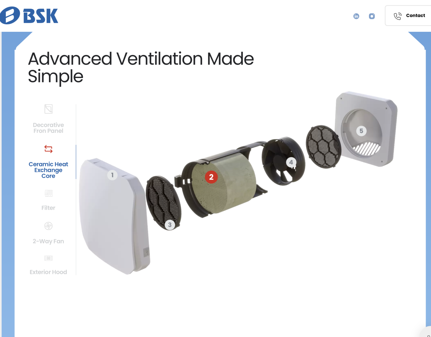

Also, theres no doubt that maintaining ventilation is challenge in improving older houses but I can’t believe that we’re still building new houses with trickle vents and extractor fans as a solution. Airtightness standards have improved, but we’re still punching holes though to outside, and sucking warm air out of bathrooms though a big hole in the wall. The trickle vents mean you lose sound insulation as well - close them and listen to the difference.
’ve not used them but this seems a very smart solutions - ‘extractor fan’ style heat recovery (so no central system and pipework that’s very difficult to retrofit required).
But you have multiple units working together with a wireless link to move air across the house.
And they’re only about £200 each. A decent vent axis extractor fan can be over £100. Seem like a bargain.
https://www.bsk-zephyr.com

I'm struggling to grasp from that site how that ceramic thing recovers heat. Its says 'heat exchanger' but I don't see the heat being exchanged to anything unless that single fan is somehow managing to suck air in and blow it out at the same time
Posted : 10/02/2026 2:08 pm
Posts: 30979
Looks like the system has to have more than one fan... I guess they talk to each and alternate between in/out.
Posted : 10/02/2026 2:19 pm
Posts: 2738
Posted by: kelvin
Doesn't have to -  It warms the ceramic with the (warm wet) extracted air, then changes direction and warms incoming air over the ceramic.  If you have multiple units you co-ordinate them wirelessly so some are extracting while the others are blowing but one can work by itself.
Posted : 10/02/2026 2:30 pm
kelvin reacted
Posts: 2738
Posted by: maccruiskeen
The issue here is architects are building houses for humans to occupy  - and the pesky blighters insist on being able to breath
Part of it is education.  Northern Europeans managed for years without trickle vents by simply opening all the windows wide to change the air in the house each morning. The theory is sound - quickly dump all the warm wet air from the house, bring in comparatively dry cold air then shut the windows.  The structure of the house quickly warms up the air and warm air can hold a lot more moisture than cold.   When I accidentally switched off our MVHR for a couple of days that worked to get rid of the condensation.
 I've never worked out if that just fails to work in a warmish wet climate like the uk (and with our cold bodied badly insulated houses).
Posted : 10/02/2026 2:35 pm
Posts: 23459
Well thats nice for the piece of ceramic.
Posted : 10/02/2026 2:46 pm
Posts: 2738
lol
they're claiming up to 90% efficiency. Which is very impressive( though I can’t find a third party test result).
“BSK Zephyr can recover heat by using a 2-way fan  heating and cooling of the ceramic heat exchanger inside. The device operates on a cycle that extracts and supplies air in periods of 70 seconds. While the air is extracted out from the room, the ceramic heat exchanger will be heated, when the air flow direction is reversed and fresh air from outside is supplied to the room, thanks to the heat stored in the ceramic core, it will be blown inside in a conditioned manner. BSK Zephyr, whose power consumption does not exceed a few watts and can reach 90% thermal efficiency, also allows you to save energy while meeting your ventilation needs. You can connect multiple devices to each other via wi-fi, and you can control your devices with the included IR remote.”
Posted : 10/02/2026 3:24 pm
