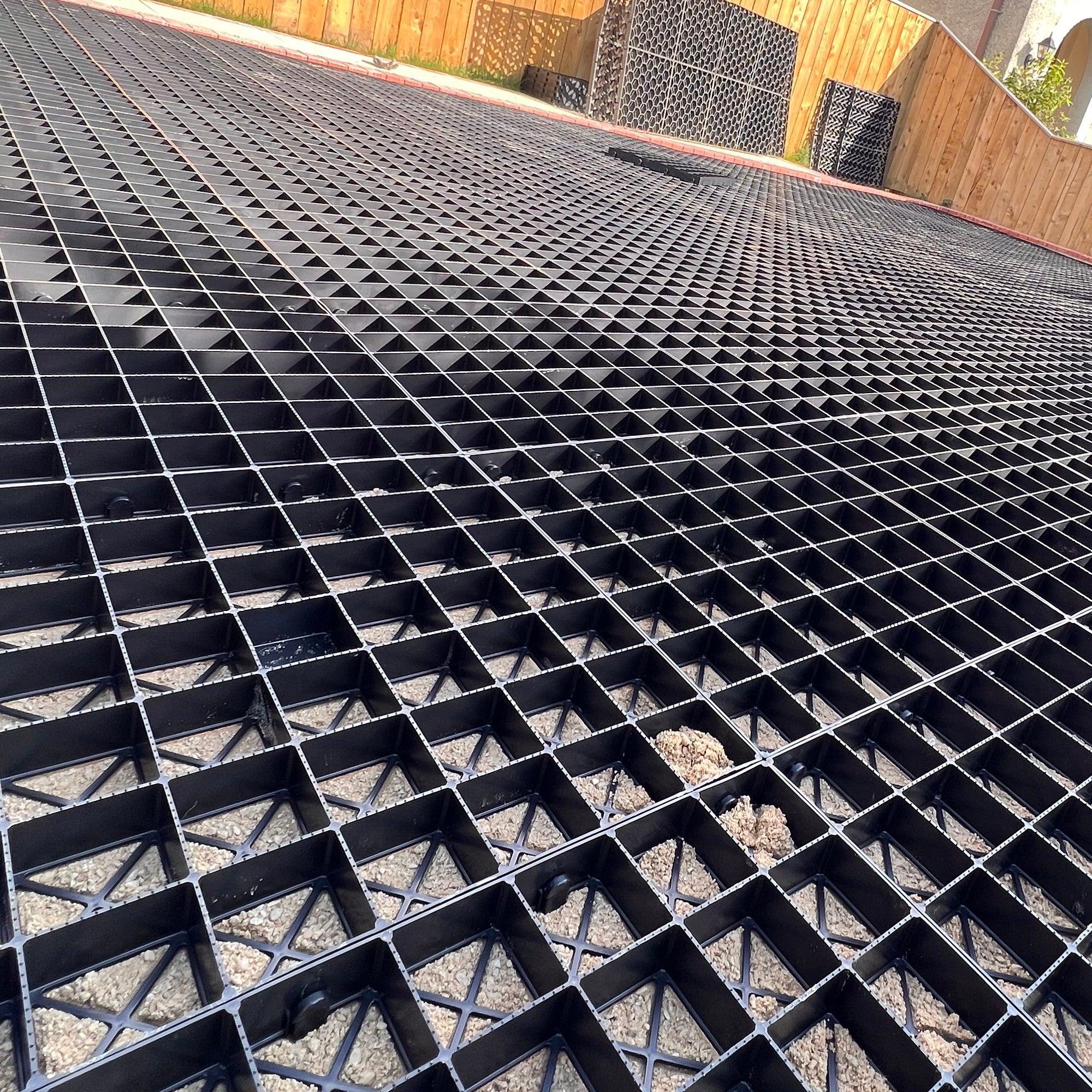

Posts: 184
I used these:
https://www.ibran.com/products/gravel-parking-grids
I put some gates in the back garden to get our caravan in which involved digging down a couple of feet to pavement level, doesn't show on the photo but that is quite a steep slope. All the gravel has stayed put apart from some that gets stuck in car tyres if it's been parked there a while.
You can either cover completely so you can't see them or just fill the pockets level like below.
They have been down four years and so far haven't budged.
Posted : 02/04/2025 6:48 pm
