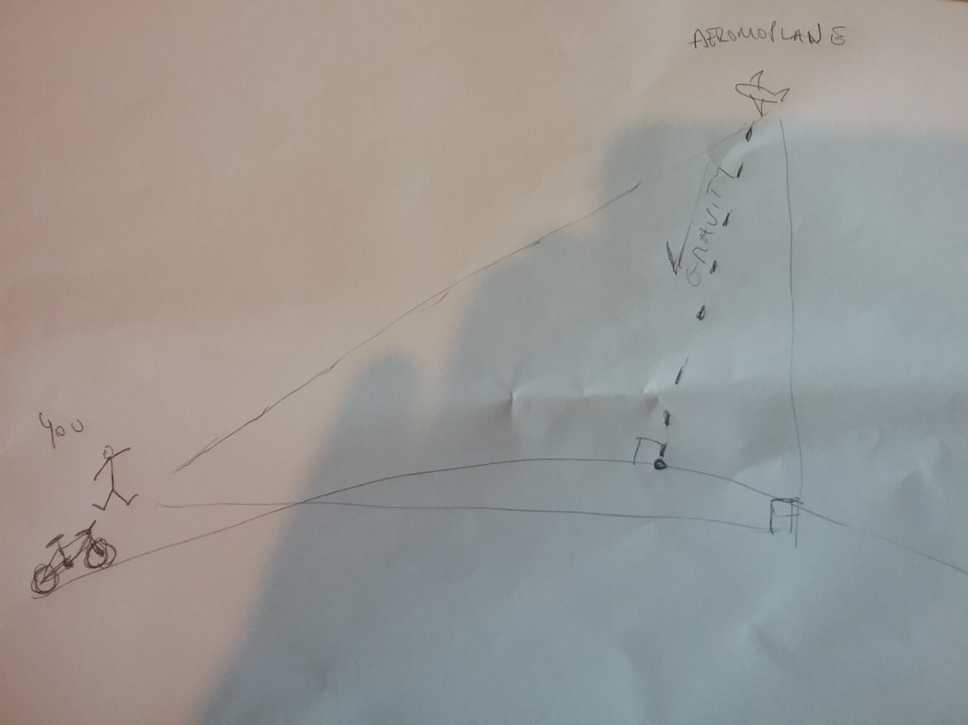

Posts: 12721
I think you are all wrong.
It's 394.5526586km (calculated)
Or it's 393.7990322km (scale drawing)
Edit, that's based on eye level 2m above sea level. And yes it's obviously wrong 😅
Posted : 14/01/2022 3:28 pm

Posts: 12721
It's about 44km.
You need to separate the 15 degrees into the angle down to the horizon from horizontal and the angle up to the plane from the horizontal.
Then from the perspective of the viewer you have the line of site line equation and the equation of the circle all based around the origin at the centre of the earth.
You then work out the theoretical intersection points and then you can calculate the angle from person to centre of the earth to the plane.
And with that you convert it to radians and multiply it by the radius of the earth.
I got my angles jumbled in my calculation
Posted : 14/01/2022 4:01 pm
