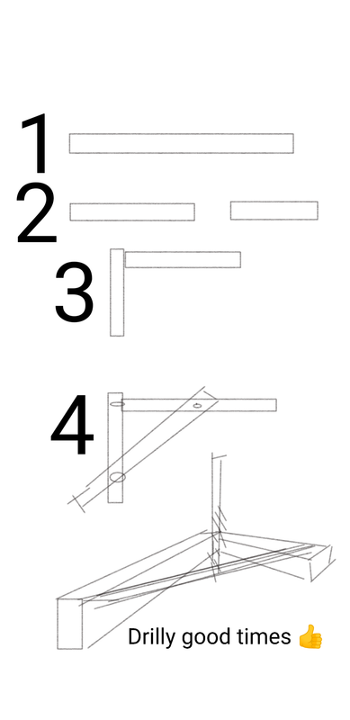

Posts: 18164
I very frequently need to make drilling guides, but I do that by pillar drilling through a piece of scrap first, holding it to the work and using it as a guide.
Presuming you've not got access to a pillar drill, a way to achieve something close might be a bit like the following. (Bear in mind it's 5am and I can't sleep and am out of it and should not currently be allowed near sharp implements 😉 )
This relies on the edge face that you're drilling being square to the main face.
Take a length of planed timber or mdf/ply that's rectangular in section, and something like 50mm wide
Cut it in half as square as you can.
Lay the pieces on the narrow edge on a nice flat surface and pivot them round towards each other like a hinge.
Stop about 90 degrees though a little further wouldn't hurt.
Lay another bit of wood diagonally across the edges a bit away from the corner and screw/nail/glue gun into place so that it braces the angled bits.
Fix some more of something on the outside of the corner (duct tape might work even)
Then putting your drill bit into the inside of the corner, use the two flat faces as a running reference to keep the drill bit straight.
I would use a brad-point bit to do as much as you can as it'll hold a line better.
Who knows, it might work. 🤔
Fat-fingered phone sketch
I'd just use my pillar drill personally... 😉
Posted : 08/02/2021 6:35 am

Cut a v notch in the end of a bit of scrap.
You have to cut the notch bang on square to the surface of course otherwise you're just leaning against an angle.
Creating the vee notch with planed timber avoids having to cut square.
Posted : 08/02/2021 9:49 am
Posts: 12894
This is very true. A good opportunity to nail square cuts 😁
If we are picking apart each others plans... Yours will be a total arsehole to balance on the edge of a board*
* This I say in jest. You are more skilleth than I by a long chalk.
Posted : 08/02/2021 10:02 am
Posts: 18164
If we are picking apart each others plans… Yours will be a total arsehole to balance on the edge of a board*
Slightly true enough of course, but all you do is screw a batten underneath which you can set up so it's dead centre. Batten on each edge if you like. 😉👍
I'm guessing it's a fairly chunky shelf too.
Posted : 08/02/2021 10:05 am
