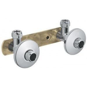

[url= http://www.plumbcenter.co.uk/en/bathrooms/showering/shower-accessories/nabis-bar-valve-fast-fixing-kit-82171 ]Get one of these.[/url] then all you have to do is run your pipes up inside the wall. The brass plate fixes to your tiles and is a compression fit onto your 15mm copper. You then cover the brass up with the chrome escutcheon and your bar screws straight onto the 3/4" thread. Job done.

Best way is with a grohe bracket. Can't really see what shower etc as only on my phone but if you can wait will look on my pc later and give you the grohe code. I always use them as they are fool proof. Do not use the s unions and tape horrible things that have a tendency to move in the wall when you tighten the shower. If you need tape use loctite thread seal. Brilliant stuff.

You can get a flush mounted shower plate with 150mm centres. You only need a 15mm elbow behind so very shallow chasing required.
I fitted one the other week and it looks pretty smart.
[url= http://www.toolstation.com/shop/p27249 ]Like this[/url]

Cheers Matt, that may be the neatest solution, these ones are cheaper too!
http://www.toolstation.com/shop/Taps+Showers/Shower+Valves/Shower+Fixing+Bracket/d240/sd3000/p68003

Ta Bear but AFAIK grohe = £££ and I have a £20 solution now.

Oh, yes, didn't spot that. But I prefer a 150 plate to 2 individual mounts.
Cranked adapters are for when you've got 2 pipes sticking out of the wall that are maybe 146 or 157 mm apart and are not quite level.

Grohe bracket is around the twenty mark too. Popular misconception I can get their stuff for less than that rubbish bristan.

Well if it's easy for you to link to it Bear, I'd be interested to see it.

If you can wait get the Grohe one. Grohe stuff is the dogs danglies. The only expensive stuff they make is the very flashy high end stuff, but then it's high end so high price.

That last one you posted is like a Shower PL8 and goes behind the tiles.
The original is mounted on the front face of the tiles and if used with a thermostatic bar mixer looks very presentable. And I have high standards. Sorry if that sounds smug, but just to say it won't look like shit.

Cynic. That's the thing but why won't it work? You use those under the finished surface gives a secure mount

You build the grohe bracket in the wall to the required depth pipes buried in wall too.
