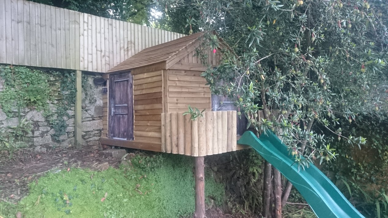

Here's my offering:
A dark, shaded corner that used to be an uncontrolled bamboo plantation in the corner of the 'wild' garden.
The base is a decking platform suspended above the hedge beneath. Front posts are reclaimed pine trunks from a local wood, one cemented in and the other on a pad stone amongst the tree roots.
Main structure is recycled fence posts from the field out the front, lots of featheredge board, most of which is left over from fence repairs after the bamboo came out.
Inside it's tongue and groove boarded with rockwool insulation between to keep draughts down. The back wall is open to the granite as a 'feature wall', with a hidden gutter above to catch any water running down the back of the main fence.
Doors are cheap plastic advertising banners, which I had printed with a random door image. These roll up with velcro, with elastic to keep them closed the rest of the time. Child-sized table and chairs inside that they can drag out to the enclosed balcony to read in the sun or eat pizza if the pizza oven is lit (again, built from mostly reclaimed and leftover stuff). The slide is lethally fast, the kids are all a bit scared of it, but the swing in the big tree behind is popular.
Careful measuring means if I'm really naughty, I can just about fit in there to sleep should I be banished from the house. In the summer it has off-grid solar lighting, and this winter I may make up a tiny wood burner for out there.
