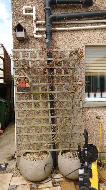

Wife is giving me grief over the soil pipe and it's glaring visibility. I've tried two big pots with alternatingly flowering clematis and climber roses etc but they need a shed load of attention and I'm not around enough to do it.
So i want to go through the patio, then the concrete path down to soil.
Anyone done similar, know of any pitfalls (i presume breaking the pipe would be a disaster), or offer any advice?

Trying to upload pics but V slow. The big vertical soil pipe that all the pipes from the toilets and sinks etc go into. I want to hide this.

I'm not burying the pipe, i want to plant some climbing plants near the base of the pipe and train them up a trellis to hide the pipe.
Pots at the bottom are no go as i can't look after them enough, so was wondering about going through the patio to soil.

Moved to the laptop:
[img] ?t=1491653850[/img]
Hiding this, the clematis and rose are sorry looking things in the concrete bowl things.

I'd move house ....failing that take the slabs and stones away build a raised bed and fill with good top soil. Tap close by you could set up an irrigation system to keep moist when not there or train your wife to water it in your absence
With your outside tap close by any soil will end up a mud bath if you go to ground level.

Easiest solution, seeing as you are right by the tap, would be one of those timer kits and a soaker hose.
If you dig a flower bed, you would only need to break through the patio/concrete path so you wouldn't be digging deep alongside the foundations.
The other thing is I'm sure a plumber could tidy up all that pipework and duplicate runs, plus change the white pipe for black. The two pipes that come out together could probably converge inside the house. And paint the pipe? One of those paints flecked with other colours.

I do have a plan to paint the pipe so it fades into the background a bit more.
Not too keen on the automatic system, I'd prefer something simple that the kids can't break.
I don't want to build a raised bed as I'd be worried about the damp proof course.
So a 12" x 12" hole is ok and the house probably won't fall down?
Result! I plan to take a masonary drill rather than a sledge hammer to break stuff up, any other surgical/delicate methods you can suggest?

I wouldn't plant anything that close to the foundations, do you want roots growing through the foundations? Do you want the roots to suck the water out and cause shrinkage (if you are on clay).....

It's not the foundations I'd be worried about if I were digging there, it's the soil pipe, which will be above the foundation. It will be a clay pipe, and could turn nearly horizontal just under the slab you're aiming a drill through. It should be a bit deeper, but if it was put in by the same person who did the white pipes, it could even be cast into the slab! Do you know where it goes, eg, where and how deep is the manhole it goes to?
If you dig a hole to plant in, you still need to get water to it. It's surrounded by slabs, which are probably not very permeable and should slope away from the house, and no more rain will fall on the hole than falls on the pots. Maybe you could divert the rainwater downpipe just round the corner of the house? Otherwise, I think you'd be doing a lot of work and risk of breaking the underground sewer pipe, for not much benefit.
