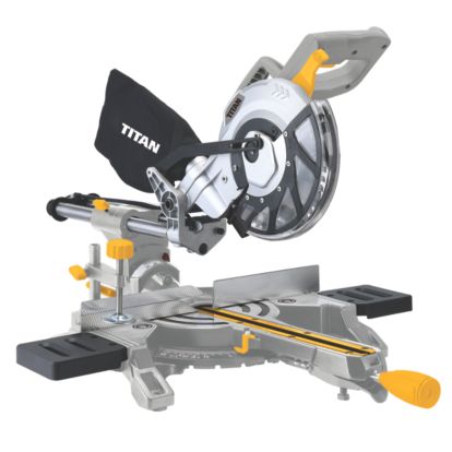

Go on - you know you want to!...
https://www.screwfix.com/p/titan-ttb794msw-210mm-electric-single-bevel-sliding-mitre-saw-240v/881kp
[img] https://media.screwfix.com/is/image/ae235/881KP_P?$fxSharpen$=&wid=414&hei=414&dpr=on [/img]
...and I bet they're not 45  degrees so buy a tube of caulk while you're there to fill in the gaps! 🙂
