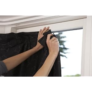

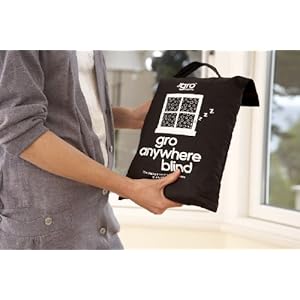

On the subject of blackout curtains/blinds, we got one of these recently:
[img] [/img] [img] [/img]
£20 from http://www.amazon.co.uk/dp/B002B55BNI
It just suckers onto the window and makes it proper dark (and warmer). Recommended, especially if you travel a lot with the kids.

Posts: 15985
Yep we have one of them too goes with us where ever we stop over! In the summer we had that on the window, then blackout blind, then curtains.
Now just blackout blind and curtains.
