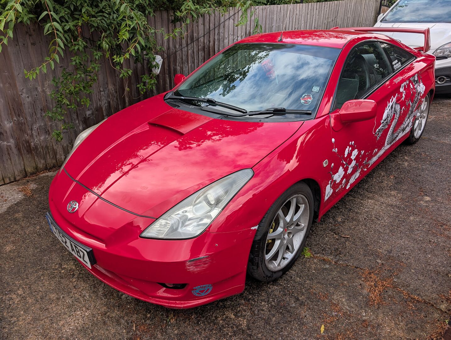

Yep, just back from 3 weeks in the garage. Failed it's MOT and needed a fair bit of work to get through. No rust though so happy to spend the money on mechanical bits to keep it on the road.
Was a bit grubby and at a car show tomorrow on a club stand so given her a quick wash and buff... PXL_20260704_171425378.jpg
