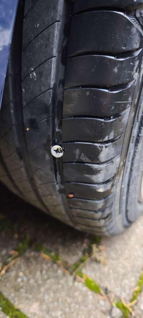

ive successfully used one of those cans of tyre weld to fix and reinflate the tyre after i found a drill bit sticking out my flat tyre
i topped it up with the electric pump in the back of the zafita.
ive also used a cheap mtb tubeless plug and a track pump, both worked pretty well, i actually drove on the tubeless plug one for ages before swapping out!
thats 2 punctures in 97k miles over the 10 years we've had it- and i only buy cheap tyres!

I've had maybe 4 punctures over the last 10 years.. almost exclusively caused by nails through the tyre. My current VW touran doesn't have space for a spare.
I've fixed it once using a big tyre worm kit. Was fine for ages.
Don't use the sealant/foam stuff unless you really have to. It'll write of the tyre and make it impossible to fix.
As said above I can't really.see what the sealant would fix that a big tyre worm couldn't.
Officially you can't use the tyre worms on the sidewall or shoulder...but if I was stuck I'd probably give it a go and just drive very slowly/carefully to the nearest tyre fitter for a proper replacement
