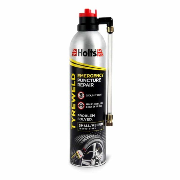

My wife had a flat tyre yesterday. No problem, I thought, there's a can of tyre sealant in the boot. Being nice I drove out to do it for her and picked up another can on the way. 2 cans of tyre sealant, topped off with a small compressor.
In the 3 miles home tyre completely deflated and is ruined. Do these things ever work?????
Can of tyre sealant

I've only ever used tyreweld for an elderly set of alloys that were prone to leaking round the rim, it fixed them fine. I don't think I'd try it for more than a small nail hole in the tread tbh, what was the damage to your tyre?
Is that what the instructions say to do?

I couldn't see any nails or other damage but it was starting to get dark.

I've used it several times with good results.
Similar to above - to cure slow leaks caused by old, corroded alloy wheels that didn't seal to the tyre bead completely.

Does it work Yes, of course it does. Used it (OEM stuff in the car, not Holts) a number of time over the years. Though I've bought some Slime car sealant, as it's not supposed to ruin your tyre, like most other options do.

It was ruined as you took the sealant to it. It got you home so it's done its job.
I was vexed to find my new lease car came with this stupid system despite me repeatedly asking for a spare. I speculatively spoke with Quik-Fit about it and they said they wouldn't touch it, it'd have to go back to the dealer to be cleaned up and replaced.

No, they don't always work. I carry a can like that, and have a fancier tyre inflation system pump thing that plugs into a lighter on a car that is too svelte/ petite to have a spare wheel. I have only had 2 occasions where I've needed to use it, on 2 occasions it failed to seal the hole...or what could be more accurately described as 'gash' from dry stonewall stones or mohassive pothole. So 100% failure rate for me.

Only ever used it once, OEM VAG stuff, worked well enough, wrote the tyre off though. Did you roll the car forward slowly to evenly disperse the sealant or did you whack it in and drive off?

Ive used Holt's and ive successfully had tires repaired afterwards. But then I have a good relationship with a local garage.
Good little scam that though automatically saying your tires a write off with once sealants in it.

I believe the tyre is written off if you use it as the garage will not clean the tyre up to repair it. I wouldn't buy a car that didn't/ couldn't get a spare for (although that might change if most car companies go down that road)

Found the zafira had lost load of pressure in back tyre, found a screw in it ,
Got the tubeless repair kit from my camelback ,plugged it, drove 100 miles
Result!

Cyclists used to tubeless must have a better success rate with these sealants. Jack it up and get the wheel spinning to get the sealant about.
And sod letting the garage write off a good tyre, I'm sure I could get a car tyre off to clean it up with a bit of effort!
I did use a screw in plug last time as it was a very new tyre and I didn't want to waste the car sealant. Had to try two garages as the first tried to imply the screw in plug had enlarged the hole too much, robbing gits (it wasn't too big but thry wouldn't accept that the snapped off bit was wider than the bit in the tyre)

Had the tyre replaced today. Hole was in the sidewall so the tyre would have been a write off anyway. That's probably also the reason the sealant didn't work - nothing to make it climb up to the sidewall!
