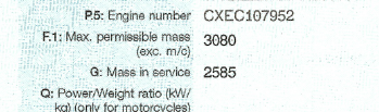

Our T6 has a GVW of 3050kg, it weighs 2664kg empty. The 7 seats it has, can only carry adults weighing no more than 65kg each and take no luggage with them at all.

Posts: 7926
I don't think that's right, unless its a camper of some kind. The california (which I guess is the heaviest interior) is >200kg lighter than that, the caravelle is 500kg lighter

Posts: 4688
I don’t think that’s right, unless its a camper of some kind. The california (which I guess is the heaviest interior) is >200kg lighter than that, the caravelle is 500kg lighter
I'm slightly out: MIS is 2585
lardarsevelle
Its not a camper, just full of seats and sound insulation. Rear bench weighs >90kg,  Captain's chairs are 40kg each.
Posted : 16/06/2023 4:56 pm

Posts: 2745
MIS includes driver at 75kg so kerb weight is 2510 kg
so if you carry full load of passengers ( 7@75kg) that leaves you a whole 15 kg for luggage 😉
Posted : 17/06/2023 1:27 pm
