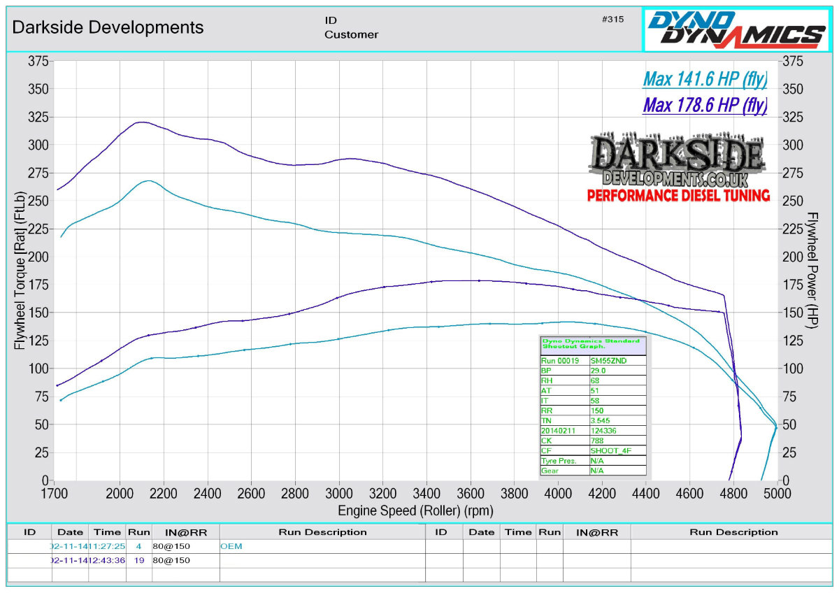

Quoting peak bhp is willy waving and not particularly relevant for every day driving. Low down torque increases are the thing you should be searching for. Have a look a dyno charts from your proposed mapper. Look at the torque curve not the peak bhp numbers that we are all drawn to (including the mapper!)
[img] ?t=1427792005[/img]

OP here again.
Having looked that the published power and torque curves, then it would appear that the remap in question does not add a notable amount of lower rev range torque.
The original max torque is quoted at 385nm @ ~ 2,500 rpm becoming 412nm at ~ 2,600 rpm. However, it holds notably more torque after 3,000 rpm. So, you have to rev it to get the benefits.
Similar story for power. Original = 156bhp @ ~3,200 rpm, remap = 208 bhp @ ~ 4,100 rpm.
So this particular remap does require higher revs to access the benefits. Given I tend not to rev beyond 3,000 rpm then I guess this is not for me.....

well interesting thread yet again from the one I started a while ago .
my real world testing now the novelty has worn off
overtaking when fully loaded is a joy and I spend less time on the wrong side of the road .
my fuel consumption is an extra 28 - 34 miles from each tankfull driving like I am paying for the fuel ( which I am )
and how I always drive .
so I am burning less fuel for the same mileage so am i killing more baby robins now or before the remap
