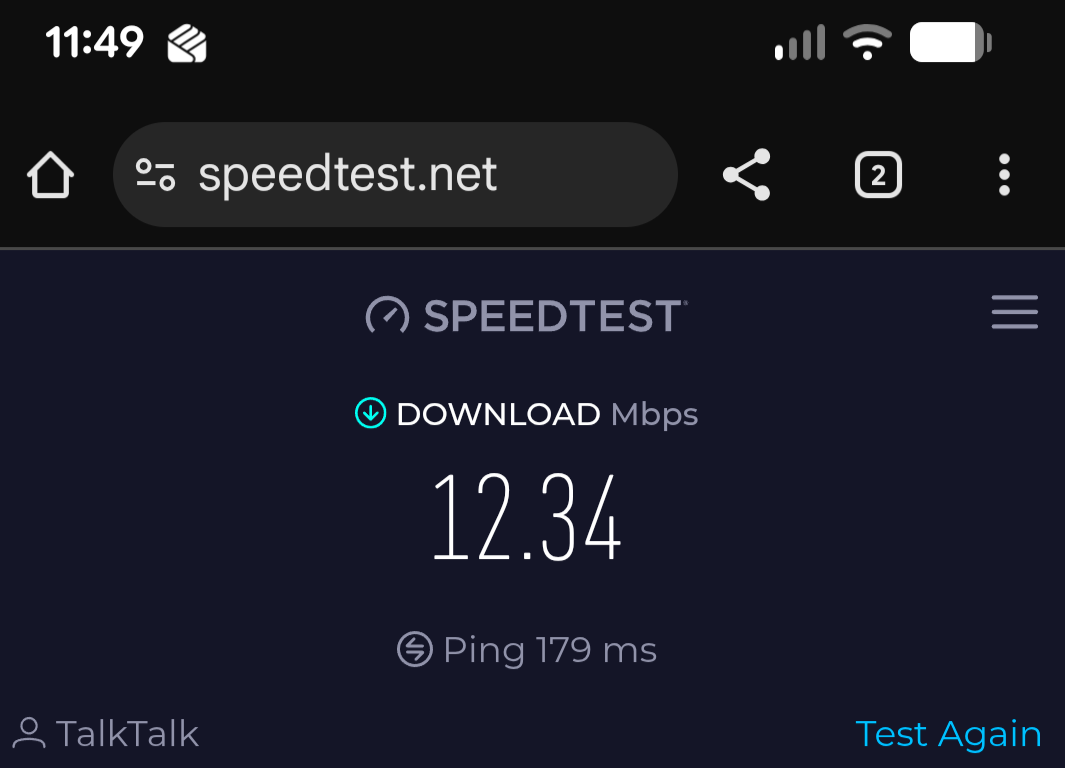

Posts: 20093
Posted by: paino
Also finding that with Virgin I get 500mb from the hub, but any deco extender gives me max 100mb….and that’s on a good day.
Hang on, let me just find my teeny-tiny violin...

Posts: 5824
Is that a life choice or no choice?
I recall IHN not being a million miles from me in the Cambridgeshire area, Fibre arrived the week before Christmas 2025, despite being a ride out of 'Silicon Fen'! Before this it was copper only and if you are too far from an exchange you get minimal speeds.
12.34 does feel too consecutive to be real though!

Well, I guess it's a choice about where we want to live, which is slightly remote, but not very. We're a whole one mile from the A6 corridor south of Manchester
Posted by: toby1
Nope, I'm near Stockport/Macclesfield.
The full FTTP connection is 'coming soon'. In fact, the loop of cable has been hanging on the telegraph pole by our drive for coming on four years, teasing us...
To be honest, I think we're waiting ages as we're kind of stuck in a grey area between 'normal' urban/suburban places that get FTTP upgrades easily cos there's loads of people needing it and you can do loads at once, and places that are properly remote that get prioritised because they're properly remote.
Posted : 10/01/2026 11:22 am
