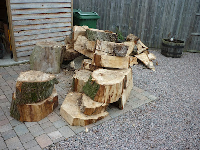

Im currently turning this
and this
into this
The large slabs of poplar were taken from my dad's garden when he had it removed. Its a git to split and Im working through it with the maul, but it's breaking my body 🙂
The willow came from some mates who sell firewood. Big Chris is a farmer and he pollards his field willows but normally they dont sell it as people wont buy spitting wood. I on the other hand have a log burner and a furnace so dont care. They brought that lot over from the farm on a couple of tractors and trailers for a few hundred quid and will last me a long time. Admittedly I have to log and chop it.
By the time Im done I should have around 3-4years worth of wood seasoned which will provide the bulk of my heating and hot water in the barn (qv furnace) for about £100 a year. Bargin.

Something that a big log can be made into
