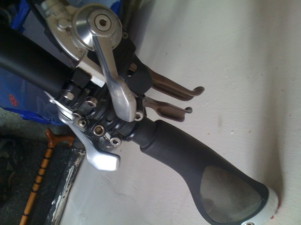

 TN
Hi. Well remembered clubber. My husband does indeed ride with one arm.
His current setup is a Felt Virtue full suss bike with avid elixir brakes. (hydraulic disks seemed easiest for control, but you need to select a lever with the reservoir in-line, because if it usually sits on top, when you flip it over, it doesn't work so well)
He has both levers stacked on the right bar and then his standard gear changers also stacked on the same bar. He does have very long fingers though, so this setup might not be suitable for someone with smaller hands. It looks REALLY busy too (will try to find a pic) but he swears it works for him.
He also has a Hopey steering damper fitted, so the suspension deals with the up/down wobbles and the damper with the side to side.
There are lots of options out there but it just happened that this way, which is pretty simple, worked for him.
Feel free to email me if you want any tips - I will pass them on to him and see whether he can help.
Posted : 19/06/2011 11:08 am
"He has both levers stacked on the right bar and then his standard gear changers also stacked on the same bar. He does have very long fingers though, so this setup might not be suitable for someone with smaller hands. It looks REALLY busy too (will try to find a pic) but he swears it works for him."
SNAP!!
Top (flipped) changer is for front mech and top brake lever is front. Its not very clear from the pic, but the ends of the brake levers aren't in line so different fingers on levers for full control.
Posted : 19/06/2011 11:39 am
 TN
LOL. Had to do a double take on that pic - I thought that was J's bike. 🙂 Same as you, his brake levers are slightly out of line so he is able to use one finger on one, one on the other so he has the same full control.
