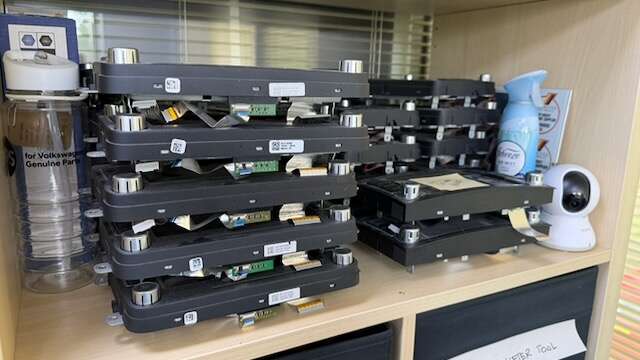

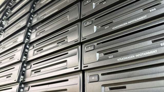

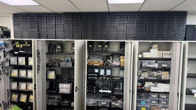

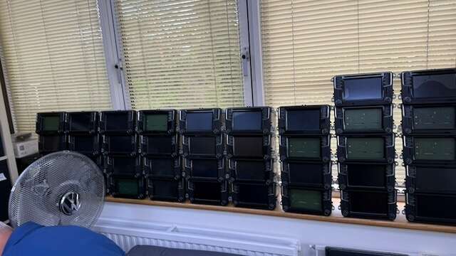

On the subject of stuff in cars failing early, I've just paid a chunk of money to have the screen replaced on a 2018 VW head unit.  Touch sensor failure in these is incredibly common apparently (and evidently - see pics). VW don't repair, and a replacement is getting on for £3k (!).
the place we went to told me 90%+ of their work is VW head unit repairs now (used to be 90% upgrades/installs). The pile of 'main units' from cars with separate screens is 2 deep!
