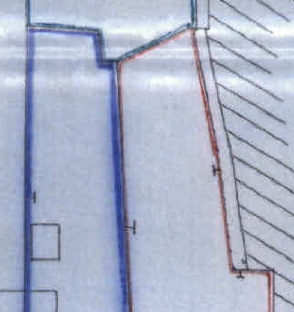

How does that plan show the wall isn't your parents responsibility?
That just shows the boundaries of the property (red line) not who is responsible for each one.
You may need to find an older plan that has little 'T's' to mark the responsibility. A T on your side of a boundary indicates it's your responsibility. This is mine (red border) - I'm responsible for all 3! Screenshot 2025-04-14 at 10.50.19.png ...
Also - if your parents boundary is the red line, and the canal is the blue section then it seems that bit of the canal belongs to them!
Posted : 14/04/2025 10:53 am
