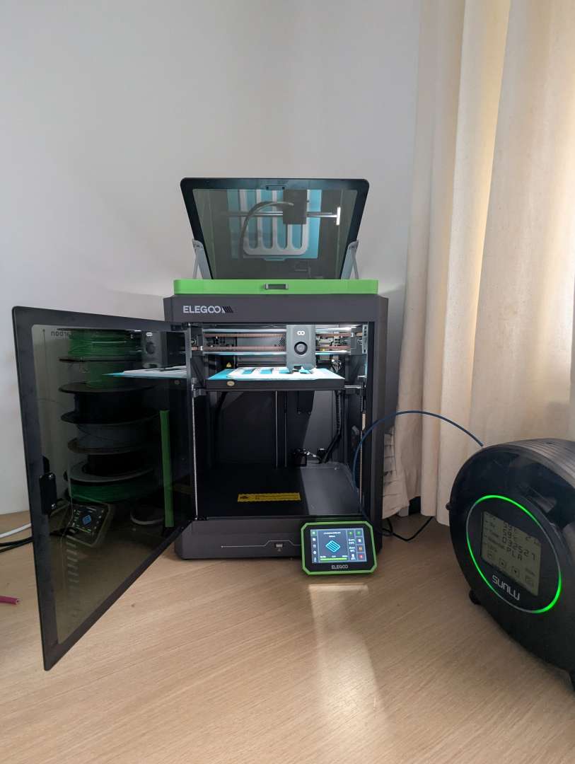

I started out with a Creality ender v3. Recently upgraded to the Elegoo centauri carbon - an enclosed XY printer. It's significantly better.
I thought i got it for a bargain at £299, but it's currently down to £239 here  which is, frankly, madness!
It doesn't have multicolour...YET.... apparently Elegoo are working on it. But all my prints are sinlge colour TBH.
Long story short - the centauri carbon is an INCREDIBLY CHEAP fully enclosed, decent printer!

I ordered the Centauri Carbon yesterday, it stated a 14 day delivery time on the website, however, it turned up today.
I'm going to find out if the "printing out of the box" claim is true!

Well the difference between the Centauri and the Ender are night and day.
Quality, speed and ease of use. The software is a bit crap and I haven't sussed how to send files by wifi yet. But really happy so far.
Interesting... if your printer is connected to the wifi, and the PC running elegoo slicer is connected, you should jsut be able to 'find it' and print direct from PC..
