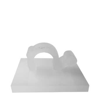

highjengin - I've put a couple of adhesive cable clips on the flattish underside of the top to carry the dropper cable
