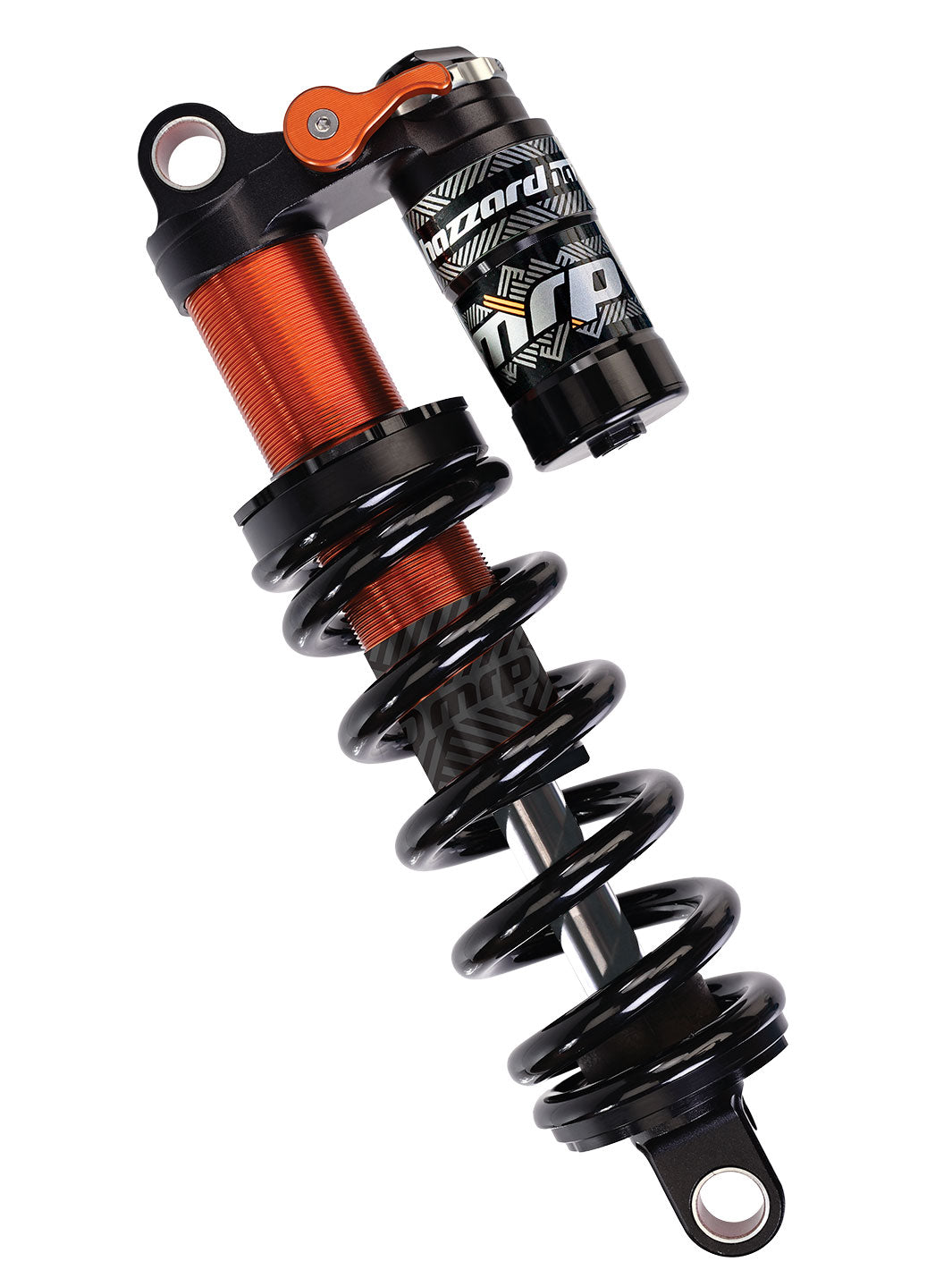

MRP Hazzard coil looks good. Progressive spring available.
https://www.mrpbike.com/hazzard/
Posted : 08/06/2018 12:00 pm

From the Jeffsy thread on Pinkbike
Posted : 08/06/2018 12:10 pm
