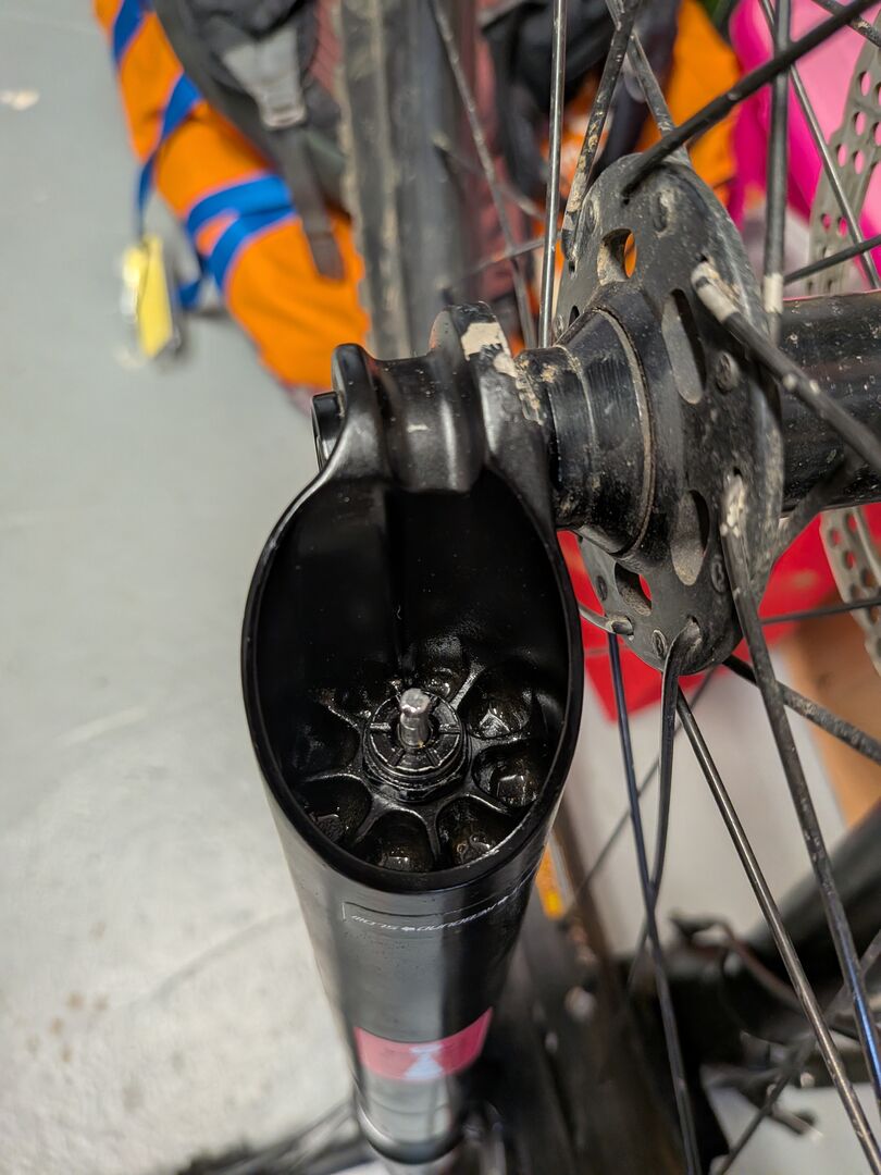

Just changed the travel on my McQueen (same as the Sweep i believe) forks and the damper footnut has taken 3-4 thread and then is spinning the damper itself so the footnut isn't tightening.
Is this a common issue and is there a fix? Has something come unattached in the damper?

I had this on a set of fox.
Put them on the bike, lock them out and push down hard.  It will seat the damper rod in the lower and you will then be able to get the correct torque on the nut.

Thanks @BillOddie….that sorted them! Magic
