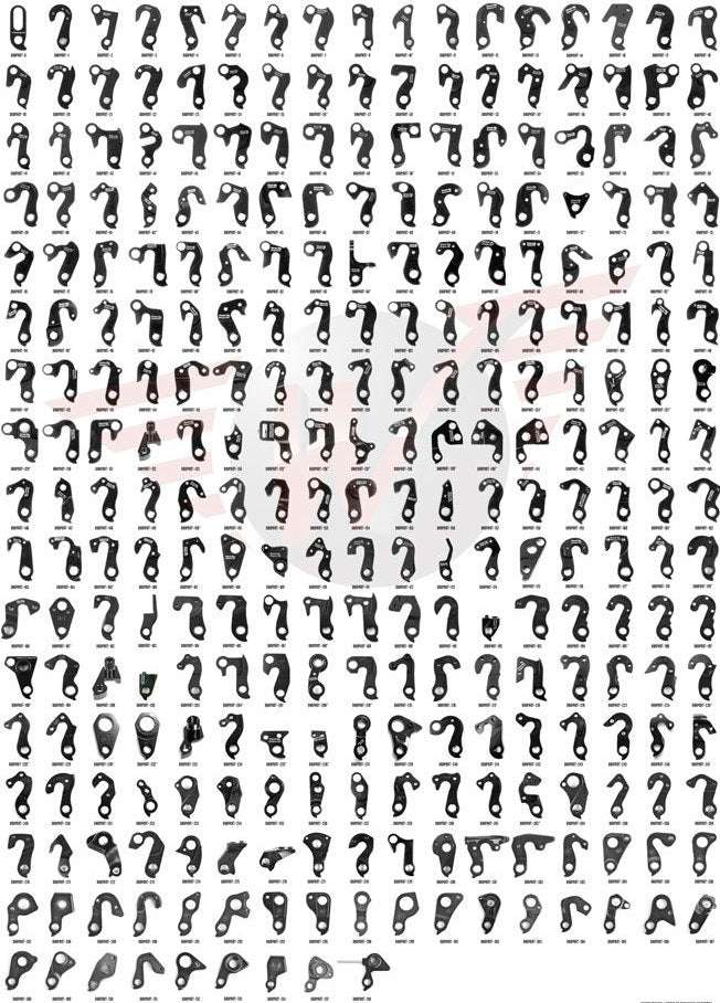

Posts: 9290
UDH is 50 million, billion times better than this...
wall_chart_2018_hanger_1200x1200
Posted : 31/01/2025 9:02 pm

I could put disc brake pads up there as well. But one pad shape to rule them all is a compromise that wouldn’t be welcome. Reducing down to a handful of pad shapes would mean all applications could be catered for, while making it easier to source spare/replacement pads. There’s a whole world between proprietary proliferation and only one option that doesn’t work for all purposes (or all frame designs).

 a11y
Posts: 4120
@shartattack, don't be daft! That's only a fraction of the real number of hanger varieties that exist.

Posts: 4120
Oh FFS, I'm so sorry @sharkattack. Too late to edit!

It sounds like a genuinely useful innovation but still not sure it merits the coverage, despite me having snapped and bent a hanger recently!
Posted : 01/02/2025 6:12 pm
jbn84 and jbn84 reacted
Posts: 433
The hype was at least one advertorial for the new Specialized Crux on road.cc which mentioned UDH at least twice a paragraph
As I recall that was about the only change, so gotta milk it
Posted : 01/02/2025 6:27 pm
Posts: 2412
I’ve never broken a UDH but I have a spare that will fit both current bikes and probably any future bikes I have. I just checked and they’re available for a tenner.
Not to mention you can walk into pretty much any bike shop and they'll probably have one in stock. I've never really understood why so many derailleur hangers were necessary most of the 20 or so bikes I've built have been different, and I've broken so many I wouldn't be without a spare, so thank you SRAM for finally coming up with something it appears frame manufacturers are getting behind.
Posted : 01/02/2025 6:35 pm
Posts: 15608
Does it though?
People bemoaning hard to source hangers… be ready for hard to source rear ends in years to come when your mech has taken it out. Although if you just avoid carbon rears, you’ll probably be fine.
Well if you're trashing a whole chain/seat stay I reckon the hanger is the least of your concerns.
I know. Superstar used to be good though. Match the shape and bolt pattern and it fitted exactly. £8 each when I last bought some. Also bought some from somewhere else but forgot where.
Fantastic! except SS aren't really an option today are they, and the faff of getting someone to machine a bespoke doodad when the industry has finally settled on a common standard feels a bit foolish now IMO.
Don't get me wrong, I've got multiple bikes and thus multiple bloody spare hangers, I've played the game for a few years myself it's not hard, just annoying. It's also sometime quite shocking how quickly hangers for some frame vanish from common sources once a model is discontinued. The best luck I've had in recent years has been through AliExpress which is obviously a bit of a gamble, ordering a (cheap) thing that looks about right on screen, typically turns out OK, but that's hardly ideal... I'd dearly love to have a couple of spare UDH and all of my bikes compatible.
Posted : 01/02/2025 11:58 pm
