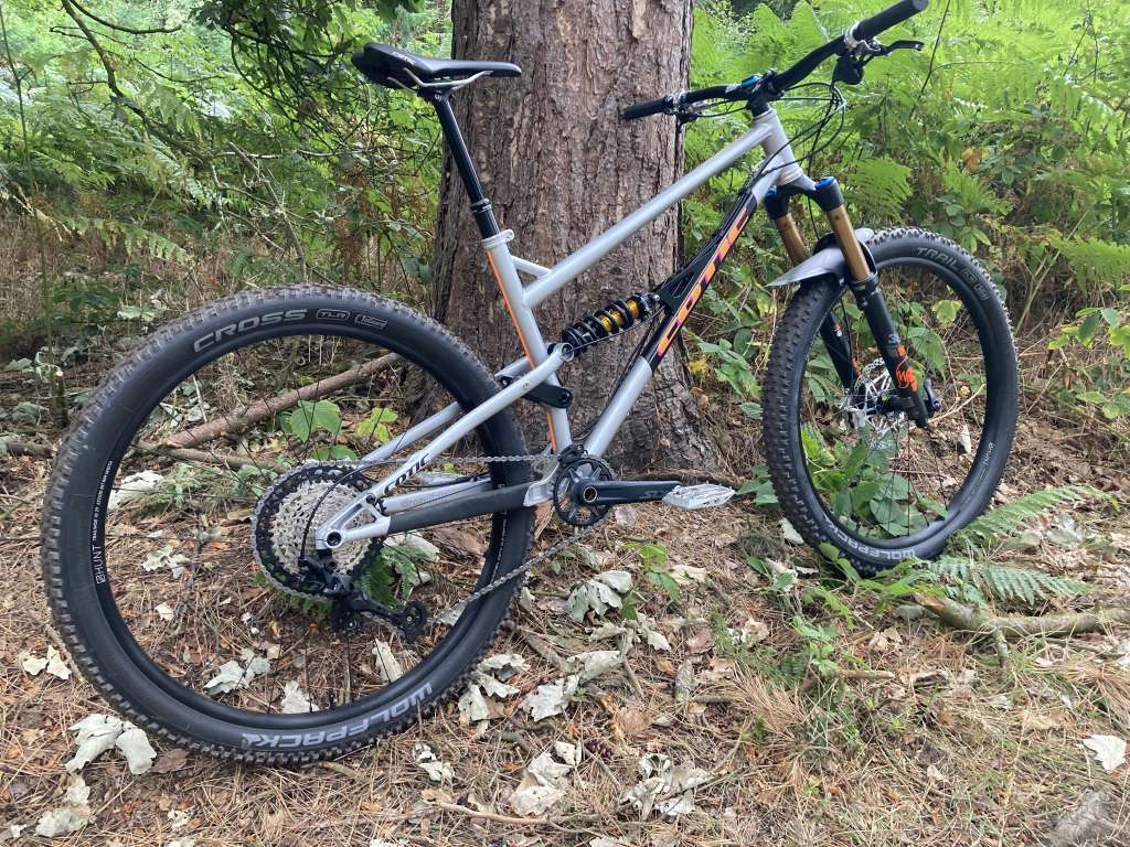

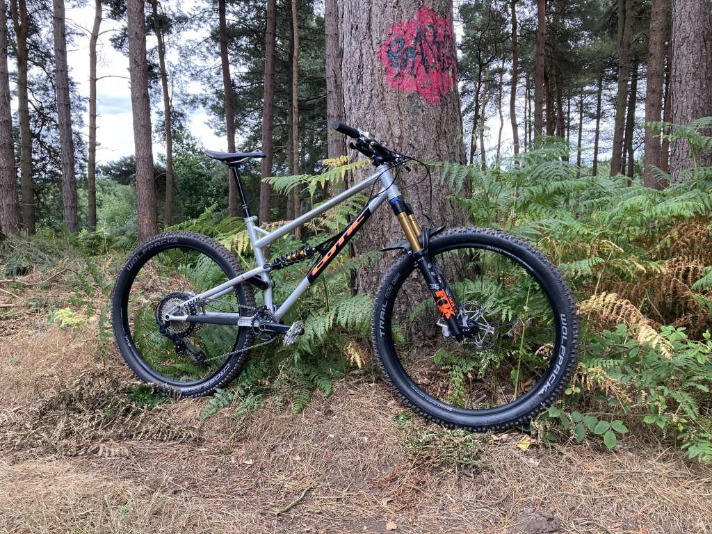

Posts: 2882
If you like the Jeht then speak to Cy about fitting a coil shock. He was fine with me fitting a Cane Creek coil as long as I followed his recommendations on spring weight.
in my opinion it suited the frame far more than the air shock it came with.
